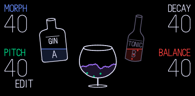

Anyway, here’s Gin v1.0.0 - A synth drum engine based on the PO-32 Tonic. Each key has an A + B side and the blue encoder morphs between these.
The main params are directly editable using the encoders and a shift+encoder setup. Then as the Tonic engine is SOOOO deep I’ve included advanced editing screens behind T1. You can then page through these to modify all 21 params in the engine.
