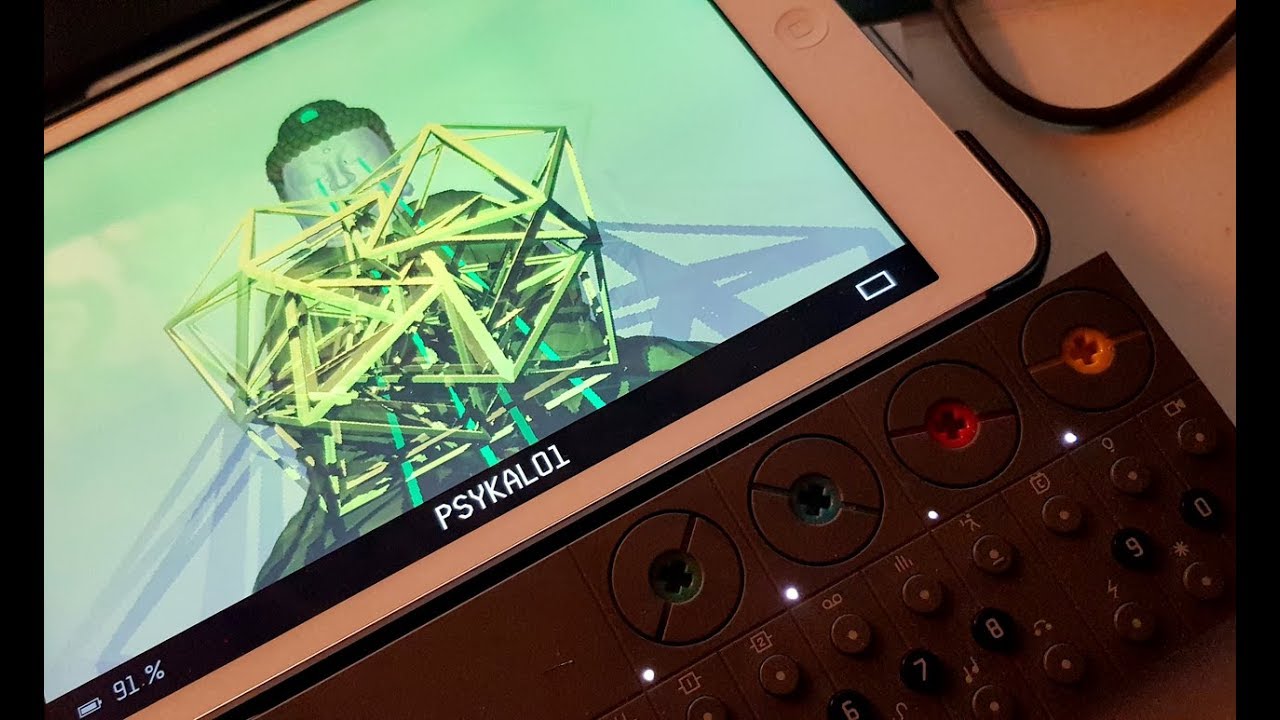

Looking real good, my man. Some pretty complex stuff going on there. What happens when you start to “hit the roof”? Is it choppy or does it just not load?
long shot here, is there any way to get rid of that black bar with the videopak name? I want to do projection and I’ll probably have to block it with a piece or tape of something…
Got some framerate drops, and also some midi stuff not regeistering. Like a kick not reacting anymore. Also I dont know if its the bluetooth midi or the app, but I got the OPZ to actually starting to freak and go totally off tempo in weird ways.
