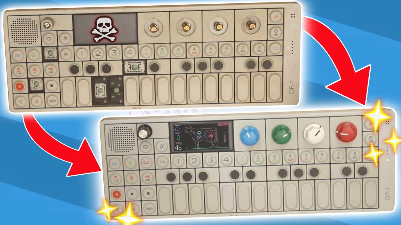

ah! here it is
Thank you. I just saw Jorb’s video. I guess I’ll follow the soldering route.
Thanks for this. Very useful indeed.
