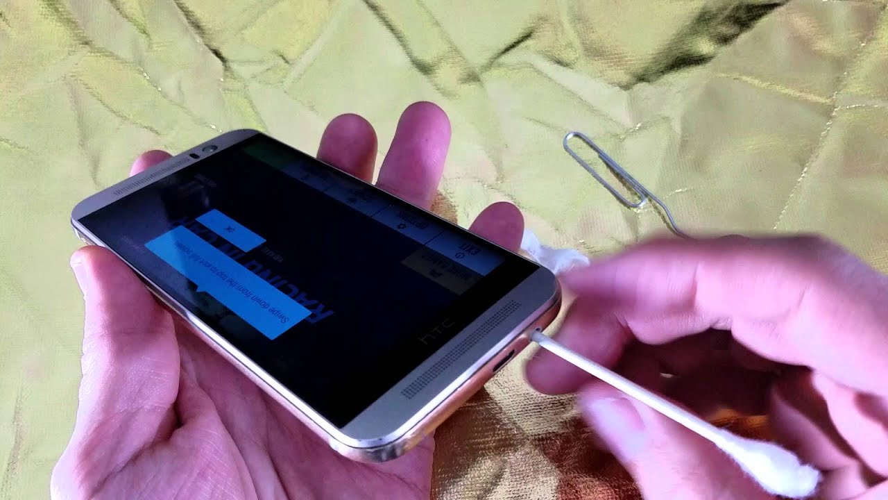

Hello, better late than never… I recently purchased a used OP1, the speaker was working for the first few days, and suddenly one morning the speaker cut out. After a bit of forum diving, I was able to find a solution!! Hopefully this can help someone in a similar situation. I was able to use a Q-tip with most of the cotton removed dipped in a bit of electric contact cleaner to resolve the issue. It took me a good 5-10 mins of cleaning before I was able to get a consistent result. My only pointer is to be gentle, the input is directly mounted to the PCB, so there is a small risk of damage (btw…this is a common issue for OP1), so be careful.
instead of a qtip u can just use a 3.5mm cable and insert it many times and work it around
much safer
Agreed…If you can solve the issue with just a headphone connector, I think that is the correct first step, the Q-tip solution should be considered as “Plan-B” only.
In my case, I tried the headphone connector solution for a few days but to no avail. The advantage of the Q-tip is that it can absorb the contact cleaner to help clean and loosen any dust or grime that caused the internal switch to get stuck.
