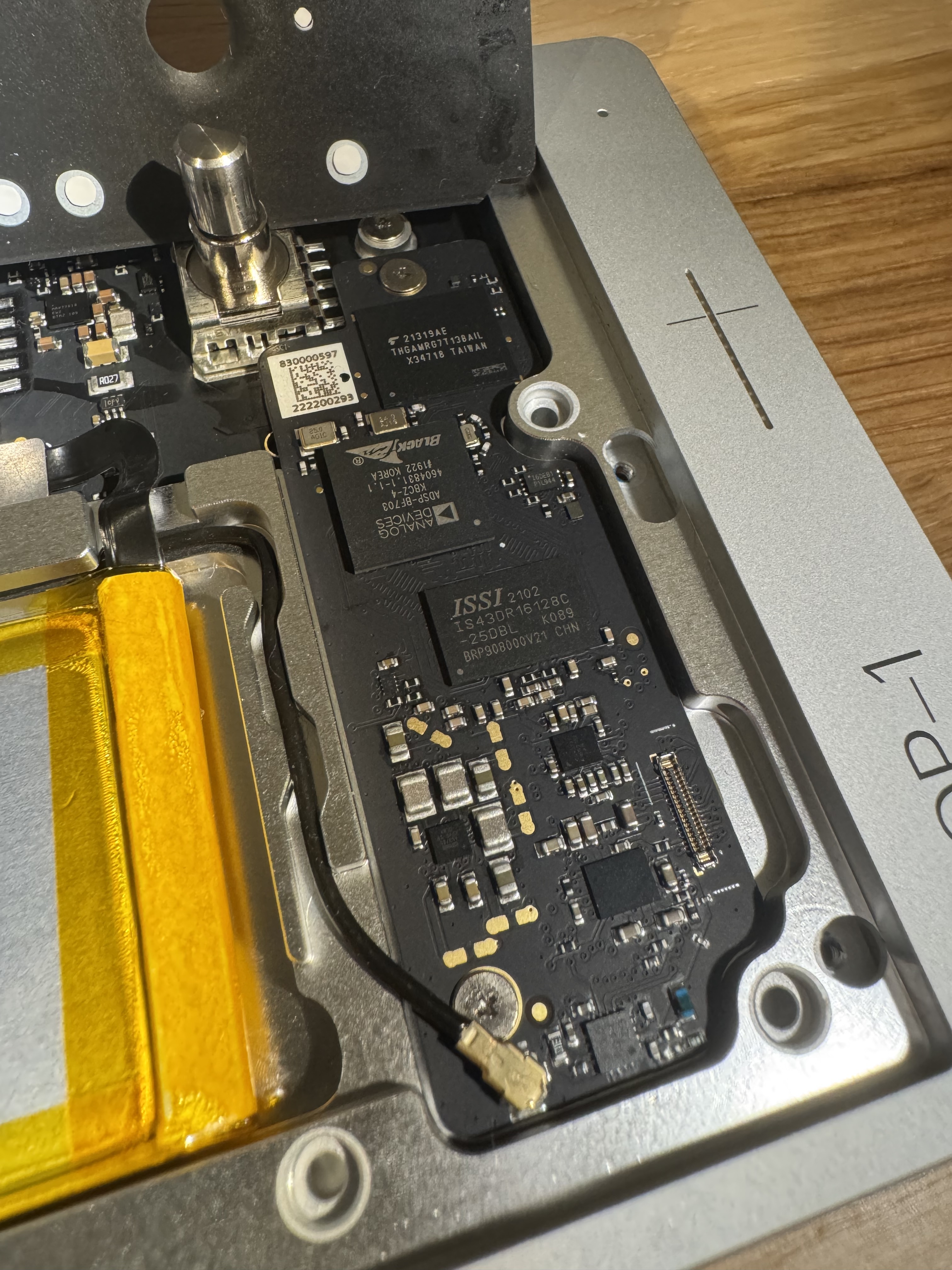

I haven’t opened up the Op1f, but the FCC filing shows that is a Blackfin chip. Can’t quite make out which one, but it does appear to be the 700 series: 002A OP-1 field Teardown Internal Photos Internal Photo Teenage Engineering AB
Here’s a defect OP-1f I had opened a while back.
It has an ADSP-BF703 Blackfin processor. Not sure if this helps with cracking the firmware!
