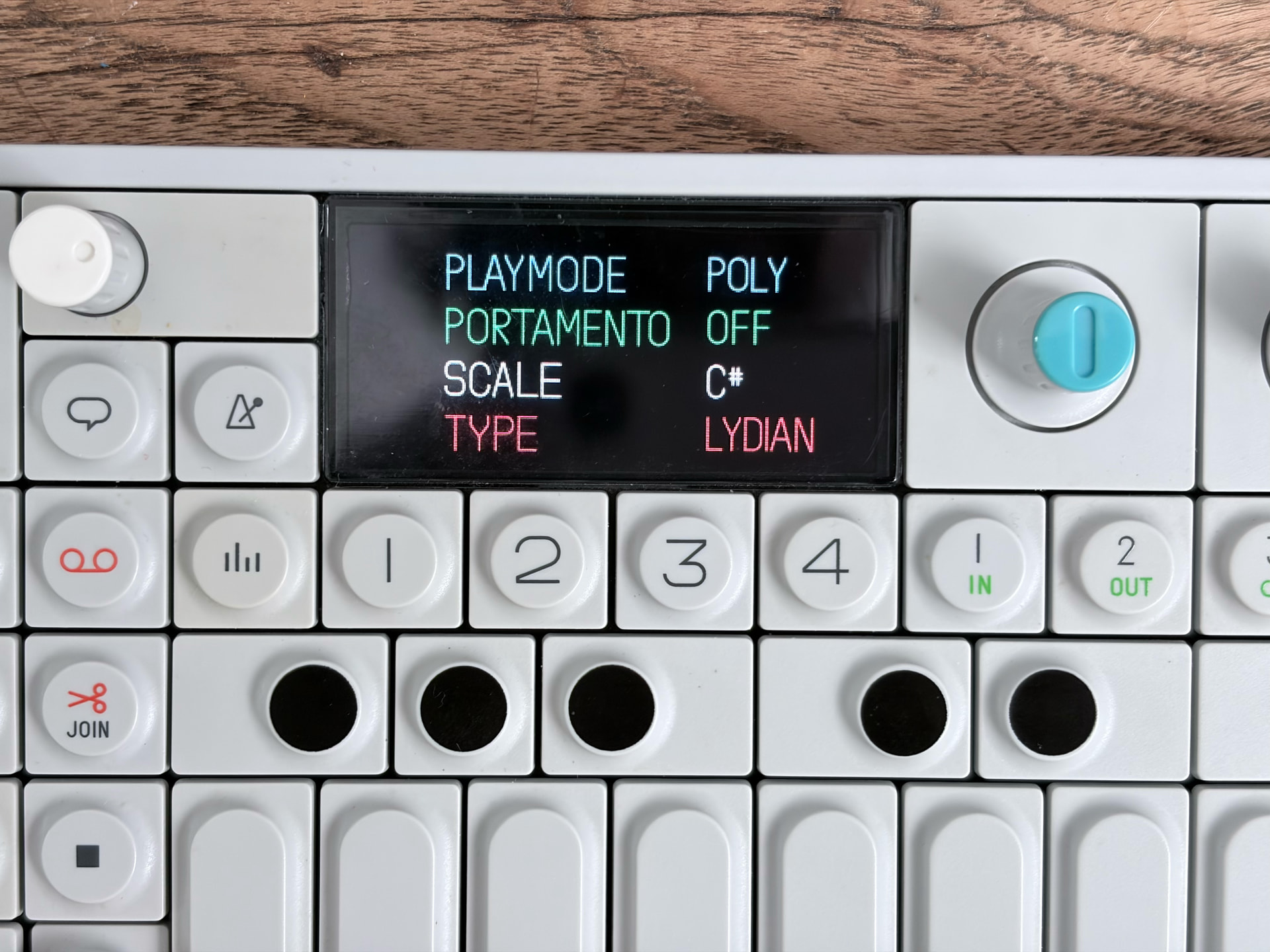

I already posted this over on Reddit, but over the past two days I’ve been hacking scale quantization into the original OP1 firmware using some of the tools that are described way up at the start of this thread.
It was surprisingly complicated. I’ve never done decompilation before and I worked with Codex on it. It was quite an adventure. One cool thing that I figured out as part of this is that I could log information out of the OP1 by editing bytes in one of the audio samples that I could mount as a disk. That helped a lot.
Anyway, I’m really excited about this for myself. It’s a feature I’ve wanted for a really long time, and I’ve noticed that people have generally asked about this feature before, so hopefully more people out there can enjoy as well. Obviously proceed at your own risk. This involves patching firmware in an unsupported and warranty-voiding way.
I’m very curious if you all figure out how to crack the xy or the 1f. If you do, I would definitely be interested in bringing this kind of feature to those as well.
Here’s a link to a github with the patch file: GitHub - stfj/OP-1-Note-Quantization-PublicGit · GitHub
