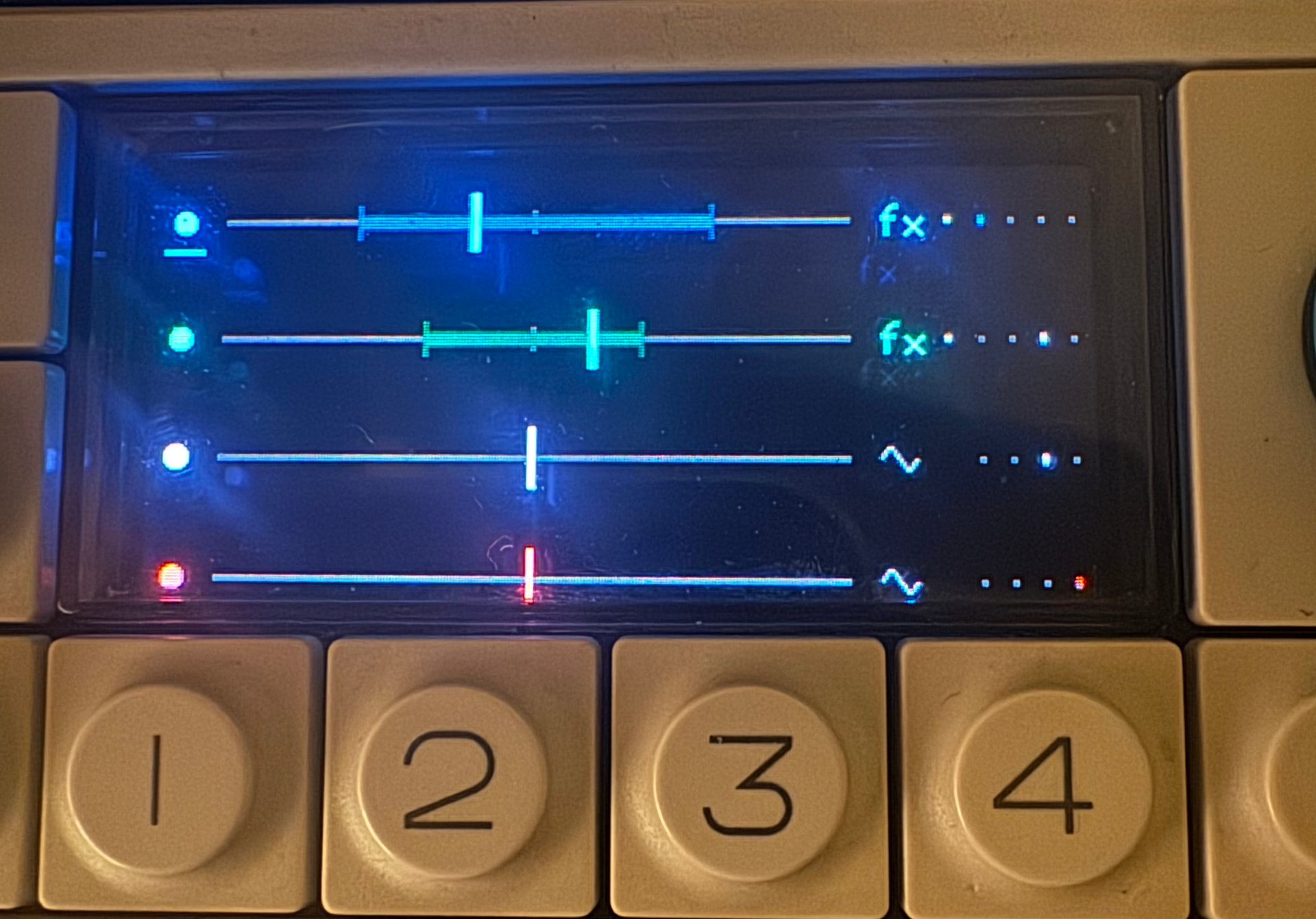

I’ve pushed an update with clouds fx (this one is quite CPU heavy and will need some fiddling to optimize the load) and a new quad LFO (can modulate 4 destinations). Obviously there are bugs in visuals but I haven’t experienced any crash so far. If you find any problems, report them via DM or in github, in case of crash a photo of the screen will be also useful

the quad lfo modulating the tape-echo is such a beautiful thing as it is really flexible and the layout, the way one can simply choose which lfo is getting edited by clicking the corresponding encoder :folded_hands::relieved_face:

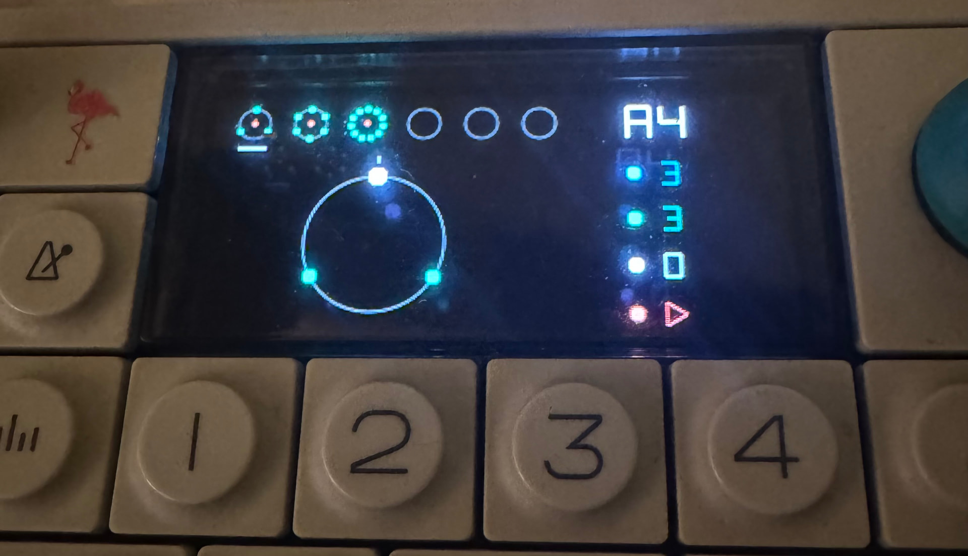

Published a new update with an euclidean sequencer w/ 6 slots. It also sends MIDI out so you might be able to sequence external gear with it :wink: Will be happy to hear feedback if anyone is brave enough to try it out!

the Euclid sequencer :heart_on_fire: absolutely crazy additions it’s like everyday is firmware update day and the quality is top notch, so much fun really having the quad lfo modulating everything and things like a dual clouds / dual tape echo is simply goated :hand_with_index_finger_and_thumb_crossed:t3: thx a lot

euclidian transpose is my favorite

hello there, just made the update and it“s working (until now) flawless! Tape and supersaw is really good!! i don“t get the euclidean sequencer, have to try more to find out how it works..supercool surprising update, thanks a lot!
ok, i understand the euclidean now, i“ve tried it with a monophonig synth, that“s senseless :wink: it“s really cool with drums!
