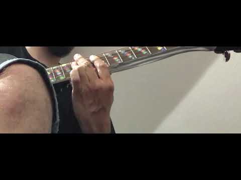

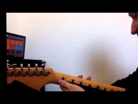

For a little over 10 years, I have been working on a controller system, placed behind the neck of a guitar, which allows with a simple touch from the thumb, behind the neck, to control and send notes to a synthesizer.
After more than ten versions, I finally have a working prototype. Here is what it looks like:
Prototype for a double controller (one at octave 0 and the other at -3 octave for big bass)
Do you think my invention deserves a kickstarter?
