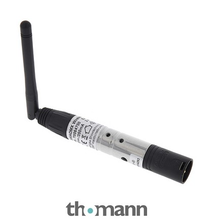

i don’t know much either but i use the enttec usb dmx pro which i think is what TE suggests. that basically gets the dmx out of your op-z and if you were using wired dmx lights you would just hook them straight into that interface. but for wireless i then route my enttec to the astera wireless transmitter but that’s because i’m using astera lights. so the missing link then which i don’t know about would be the wireless box which transmits to whatever your light is…
Probably the safest way would be to get the recommended enttec usb controller and hook it up to a wireless dmx transmitter, like this one:
