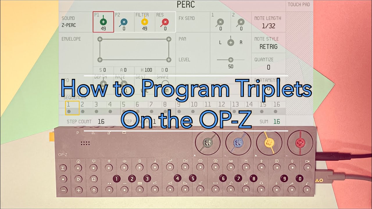

This is an OP-Z Tutorial inspired by a question on the forums about triplets. So I did the math and found the number of nudges to do to make triplets on the OP-Z.
