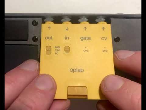

This fix solved my Oplab trouble immediately and permanently. I used a thin foam that had an adhesive backing so I can remove and replace the module and still have consistent connection. My Oplab was nearly unusable after trying a few other fixes like contact cleaner on pda and contacts and firmware updates and resets. It is now and has been completely 100% functional
I was specifically having CV control issues. You can test this theory by pressing the back of your OP-Z where the module is and I can bet you will get cv control back. This wedge trick will keep it in good contact. Just don’t forget to flip the lock down!! It won’t activate the module if you don’t do that! Ask me how I know
