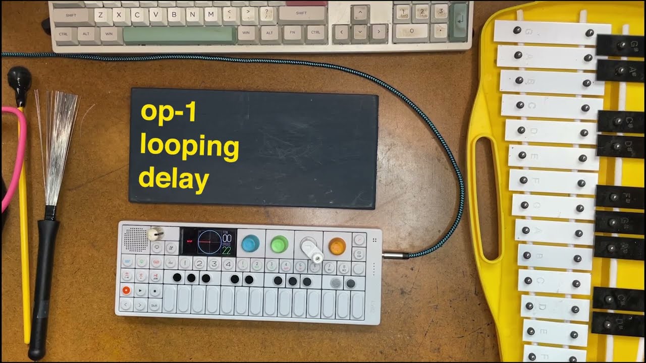

Heya. Sorry if this has been covered but I made a first of 2 or 3 videos exploring using the Delay effect as a looping delay. I love the happy accidents that build up and its nice that you don’t need to use up a tape track to accomplish it. Enjoy!

Great tip!
I like looping with the delay in a similar way to Dakim here:
Looking forward for your next videos,
Thank you!
This is cool, played around with this yesterday and then it was 3 hrs later… tried to match the bpm and the delay speed… 75 bpm and 26 came pretty close to match 1 bar and 1 loop… maybe the hive mind can figure out exact matches, this would make this technique even more powerful… but slowly drifting apart tape and delay loops is also cool… also had good results with an lfo on the input, so the recorded signal varies in level.
