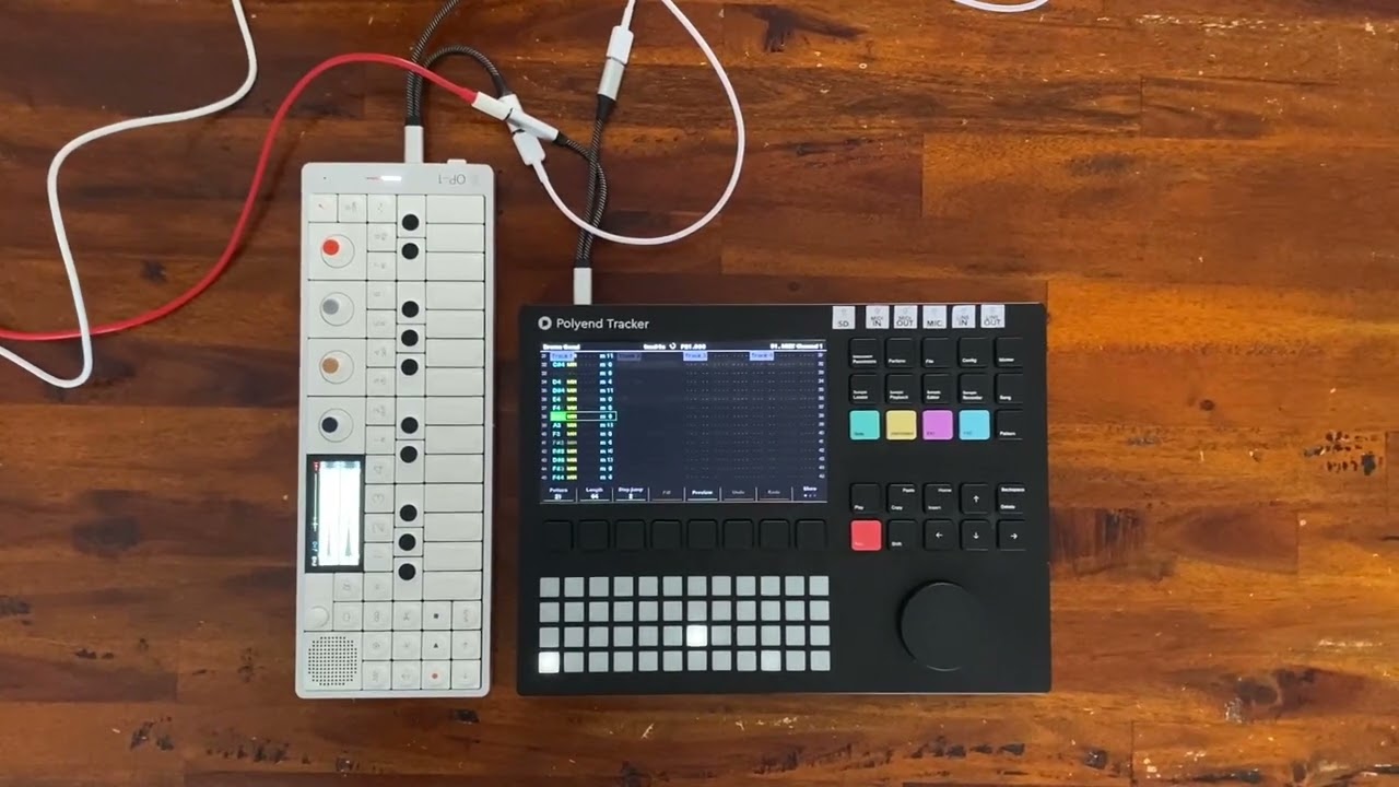

I got a USB-C to USB-C/USB-A splitter, but unfortunately no luck so far. When connecting USB-C from the wall into the splitter, and the splitter into the the OP-1, the OP-1 receives charge. But when I connect USB-A from the splitter out to the Tracker, the Tracker receives no charge, and the OP-1 also stops charging.
The other option looked to be more successful: from the wall to the splitter into the Tracker, and then out of the Tracker to the OP-1, both devices charge. :partying_face: But then there’s no MIDI running either way. It feels like when the splitter passes charge, it won’t also pass MIDI.
I might try a second splitter, so that both devices get their own charge, and one USB channel is reserved just for MIDI.
I’ve tried a cable like the one in the photos above, but no luck on my end either! I wonder if I need to just bite the bullet and use this guy:
Using a different splitter with power coming from the wall into the OP-1, and a USB-C cable running from the OP-1 into the Tracker, still won’t work. HOWEVER! I did manage to get the second idea to work: both devices now have their own splitter that receives power from the wall, and the remaining end of both splitters is used for sending MIDI back and forth over a USB-C cable. Here’s a video in which the OP-1 sends clock to the Tracker, plays music from the tape, and the Tracker simultaneously sequences an OP-1 drum kit.
I do have to admit that this contraption is kind of a balancing act. Powering both devices this way always works, but sometimes MIDI just won’t. I’ve had it happen that just by unplugging/plugging a single cable and rebooting the Tracker, MIDI suddenly sprang to life.
I think your mileage may vary a lot depending on which devices you use for this setup. As an example: receiving charge from the wall to the splitter into the Tracker, the Tracker won’t boot, only when it also receives some charge or signal over USB-C from the OP-1. So the Tracker looks te be very specific about what current it needs, unlike the OP-1, which charges no matter what stupid charger you use.
I’ll try this whole setup over a consecutive period of time to see if at any point either the power or MIDI drops, or to see if in the end it’s still the OP-1 powering the Tracker instead of the wall current.

However, this suddenly did work, both power and MIDI:
As an example of how unpredictable this whole setup is: when I unplug the splitter from the OP-1 and directly plug in the white cable, MIDI stops working. :laughing:
I need to retrace my steps a little here. Powering both devices from one single power bank does in fact work, even quite reliably so:
Unfortunately I need to emphasize that all of this is no guarantee that it will also work for others. For instance, the two spitters are same shop, same brand, same specs. But when I swap them, the whole thing just won’t work anymore.

Eventually I got two of these (for future reference, it’s called the MOGOOD USB C Y splitter cable).
Whatever I tried, the OP-1 won’t both charge and do MIDI. But the Tracker would, although it’s not very reliable. In order of most to least probable:
  • MIDI won’t work
  • Tracker boots with a flickering screen, as if it’s just barely receiving enough charge
  • Sound won’t work on the Tracker
  • Tracker won’t boot altogether
The usual remedy is just replugging and trying again.
One single USB-C cable between an OP-1 and a Tracker does everything I need, except providing charge to both. I do believe that if your Play+ receives charge and MIDI from the OP-1 the same way, that a comparable setup with USB Y splitters should also work. But it wouldn’t be reliable by any stretch of the imagination, unfortunately.
