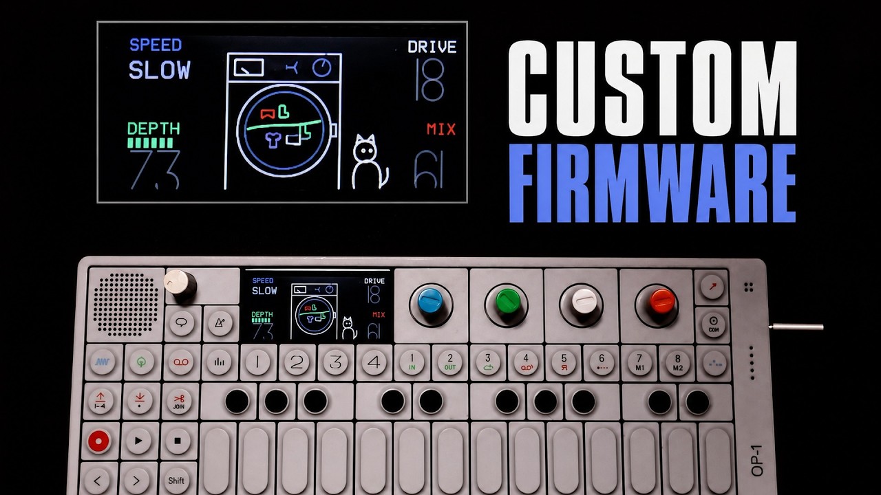

OP-1 Mods 1.0: KEYS engine, TRACK piano roll, six effects (patch for stock 246)
I’ve been building a mod for the original OP-1 and 1.0 is out. Video first:

  • Six effects with their own screens: CRUSH, BELL, MOON (phaser / Uni-Vibe), MIMIC (tempo-locked delay), LINGER (plate with freeze), SPIN CYCLE (rotary, stereo on the master)
