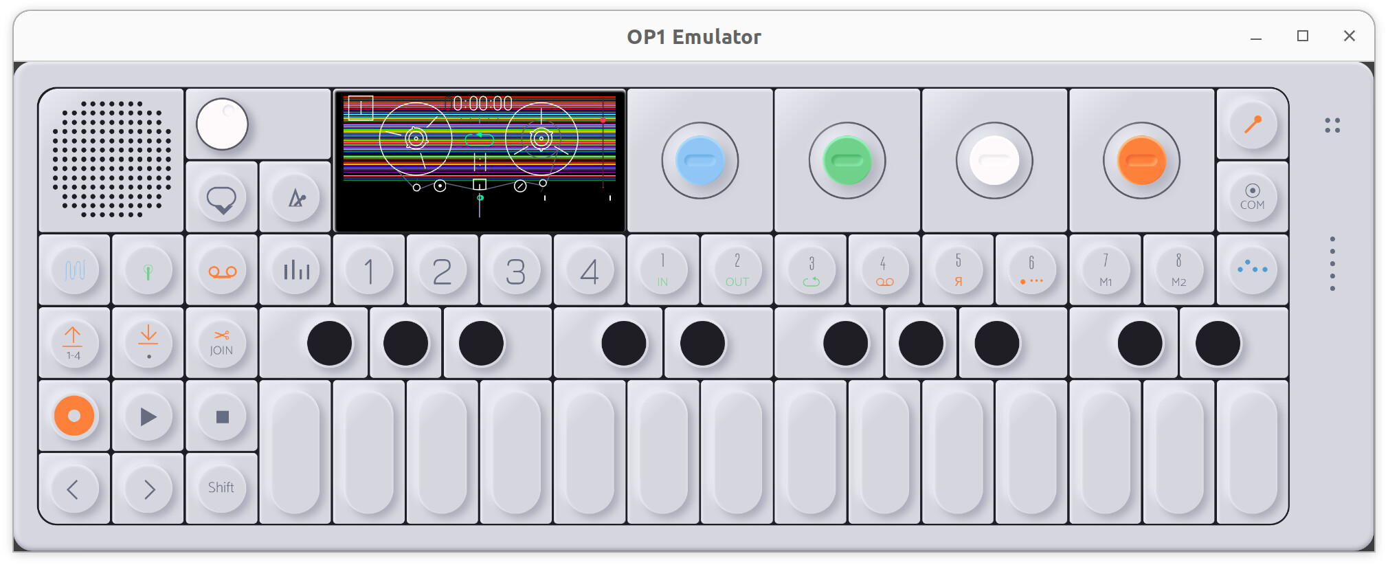

Hi all, it is 2026 and I am building an OP-1 emulator.
Recently, I built a Blackfin JIT recompiler (largely through vibe coding): GitHub - op1emu/bcore: Blackfin core JIT recompiler by vibe coding · GitHub
Using that, I’ve been piecing together an actual OP-1 emulator and have made some solid progress: GitHub - op1emu/op1emu: OP-1 emulator (WIP) · GitHub.
Current Status & Features:
  • Since te-boot.ldr is not encrypted, you can boot with it directly.
  • Most peripherals are already working, including the keyboard and the display.
  • You can also successfully flash the firmware via USB.
The Challenges:
Running the full OP-1 firmware is much trickier. It is encrypted and has to be decrypted using the key stored in the OTP memory. Because distributing that key directly in the GitHub repo is a legal gray area, I haven’t included it.
However, some other brilliant folks in the community have already dumped the key. If you provide it, the emulator does boot up, but there are still a few significant flaws to iron out:
  • Graphics: The screen currently renders with weird, straight color bars.
  • Audio: The emulator still isn’t fast enough to produce continuous, stutter-free sound.
This is a massive undertaking, and PRs are incredibly welcome!

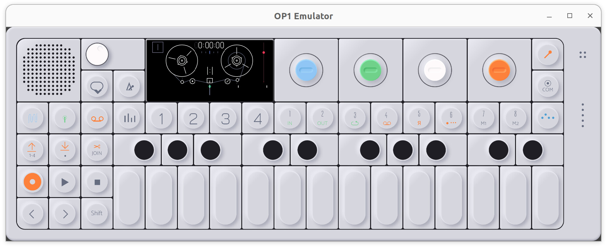

Recently I finally found some time to polish this hobby project — I had an agent fix that display issue. Turns out it was a bug in the MDMA implementation, and now the display finally renders correctly. Next up, I’m going to work on optimizing the speed.
