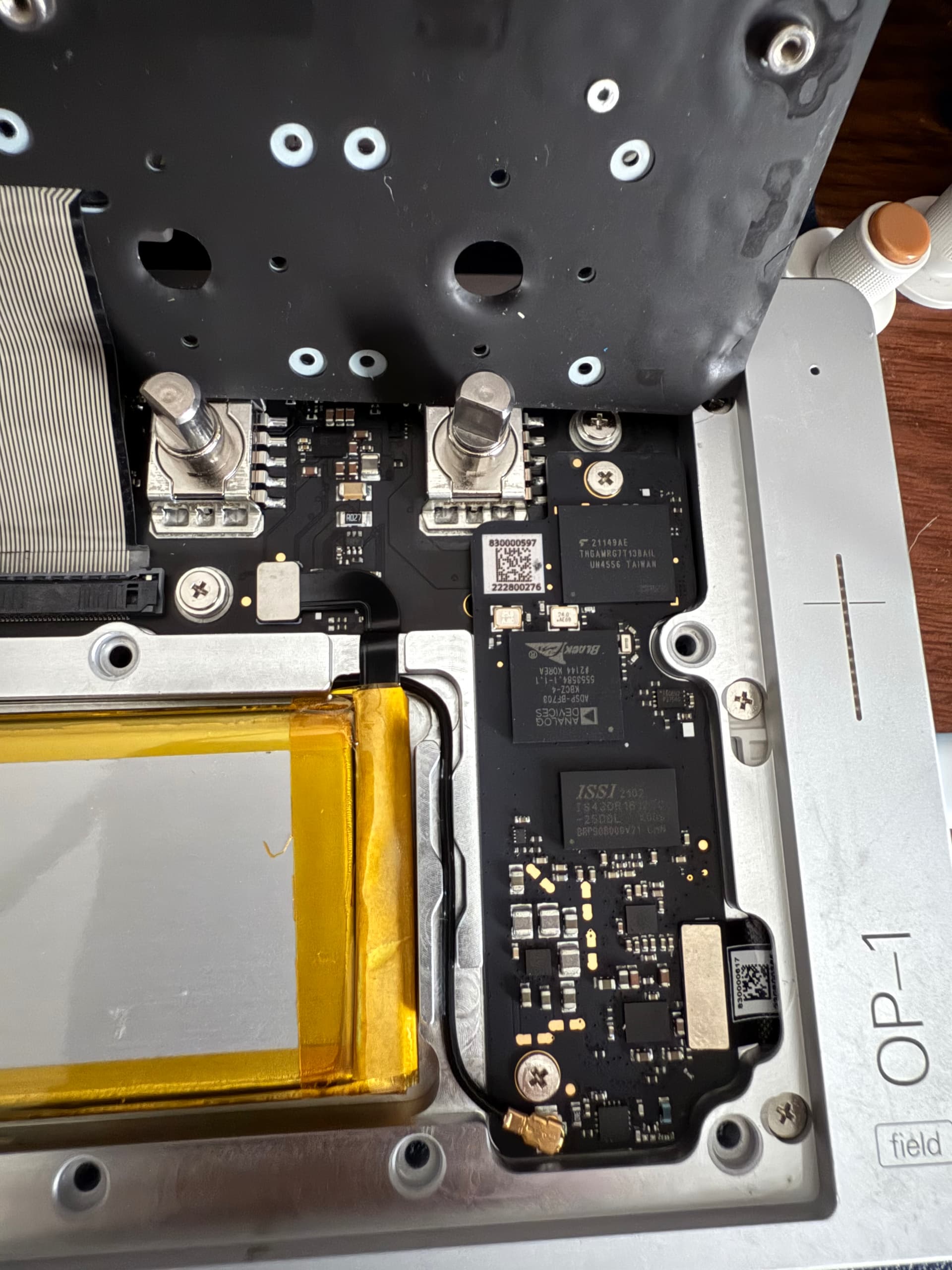

Here’s the insides. I have a broken one that has a bad board so I decided to look inside it.

Thank you brave soul! Any more pictures you end up with, please share! I’m saving them all for the eventual day I need to do the same.

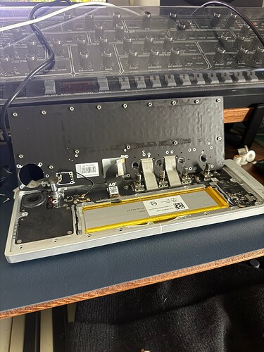

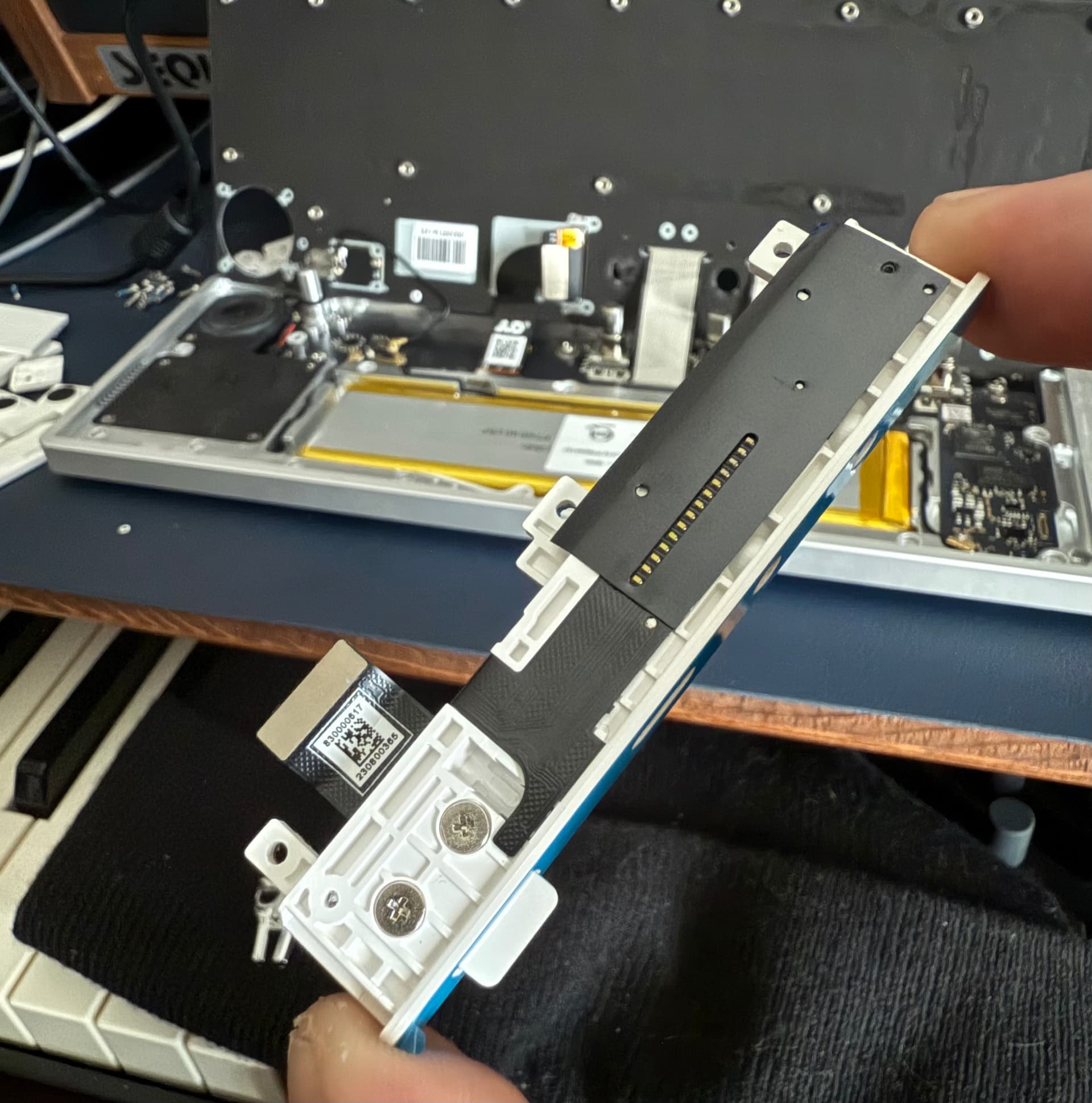

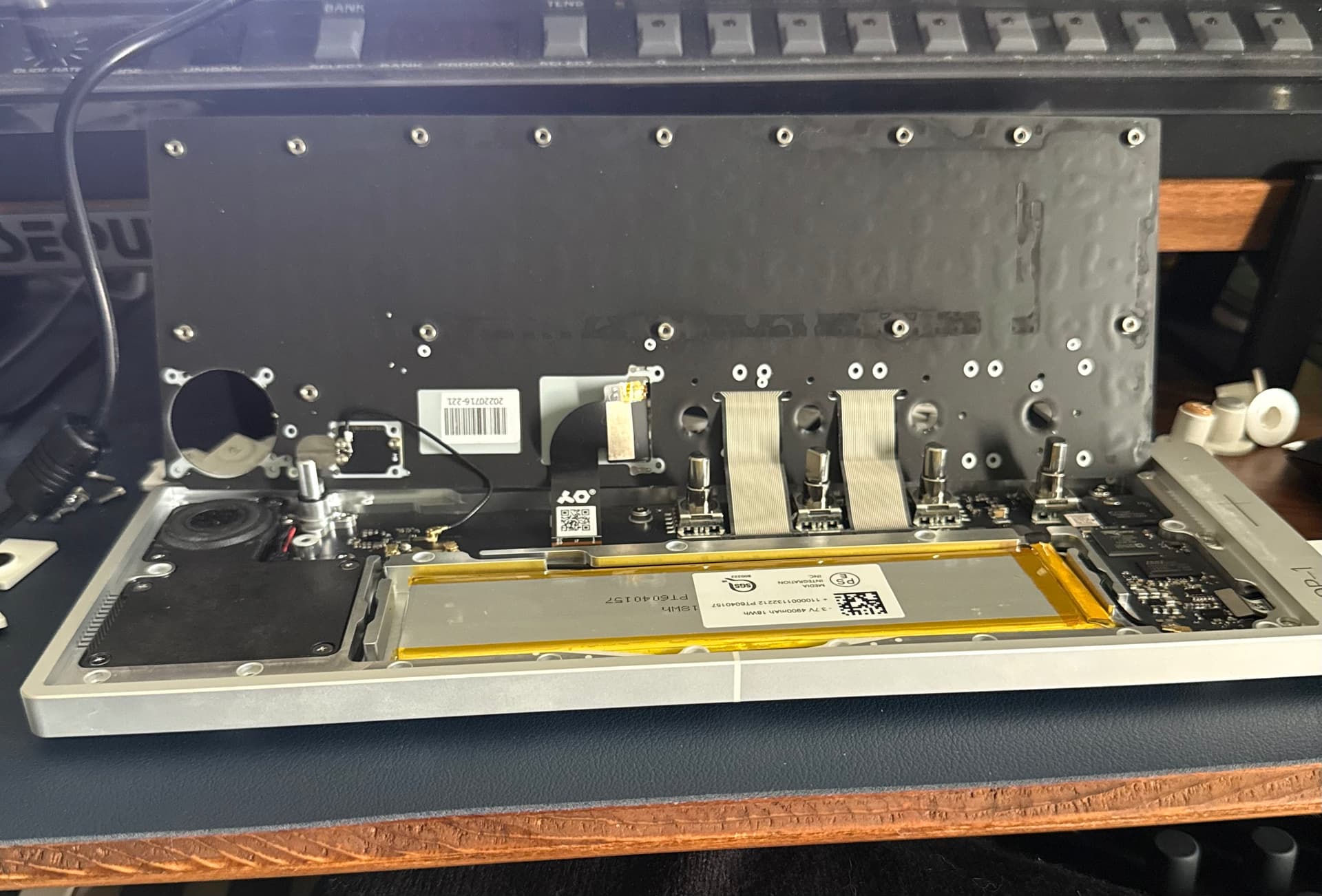

I already put it back together but basically the white part of bottom of the field is a piece of plastic glued on. You need to remove that and then you have access to all of the screws.
From there you have to take all of the keys off as well as knobs, speaker cover etc.
Once you have everything off the front panel you have access to the board that holds the keys. You need to carefully pull up from the bottom half and then toward yourself to get the top half free. The top half sits inside of a channel pretty snugly.
At this point you have access to everything. Battery, audio board etc.
To remove the up board there is one ribbon cable you need to disconnect that you can gently pry open with a fingernail. When that is free there are 3 screws to remove the IO board. It slides out of the unit. You can tug on the power switch to get it to slide out.
