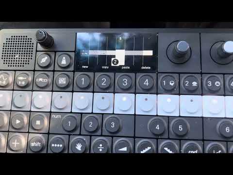

I have a strange issue, It’s only happening on this project. It seems like no matter what I do, this extra “step” keeps adding itself in between patterns causing a short delay on when the next pattern is supposed to start. Basically it’s almost like the master track is playing 17 notes. I don’t know, hard to exolain. Here’s a video showing what i mean. Please let me know if anyone has any ideas!
Recap: extra step playing at the end of my patterns while transitioning to a new pattern.
This causes everything to be one step off.
I checked the step parameters on affected tracks and there are none.
In the video, you can hear it right after the first pattern, before the second pattern starts, and so on in every pattern transition afterwards.
When I start the patterns on their own, outside of my arrangement, they start on time, no pause or extra step at all.

Likely a Step Component throwing the timing off is my guess :frowning:
I’ve run into something similar a couple of times.
In each case the culprit has been a second page added to a pattern with just 1-2 steps. I figure I must have hit + and pressed step 1 or 2 while holding BAR at some point–that would add a second bar/page with exactly 1 step on it (16 steps on the first bar).
This could happen on an Instrument or Aux track, so you’d have to check both of them.
