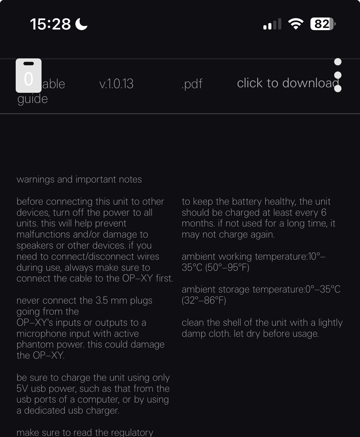

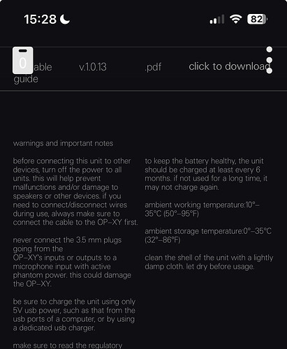

From the TE online manual
be sure to charge the unit using only 5V usb power, such as that from the usb ports of a computer, or by using a dedicated usb charger.
