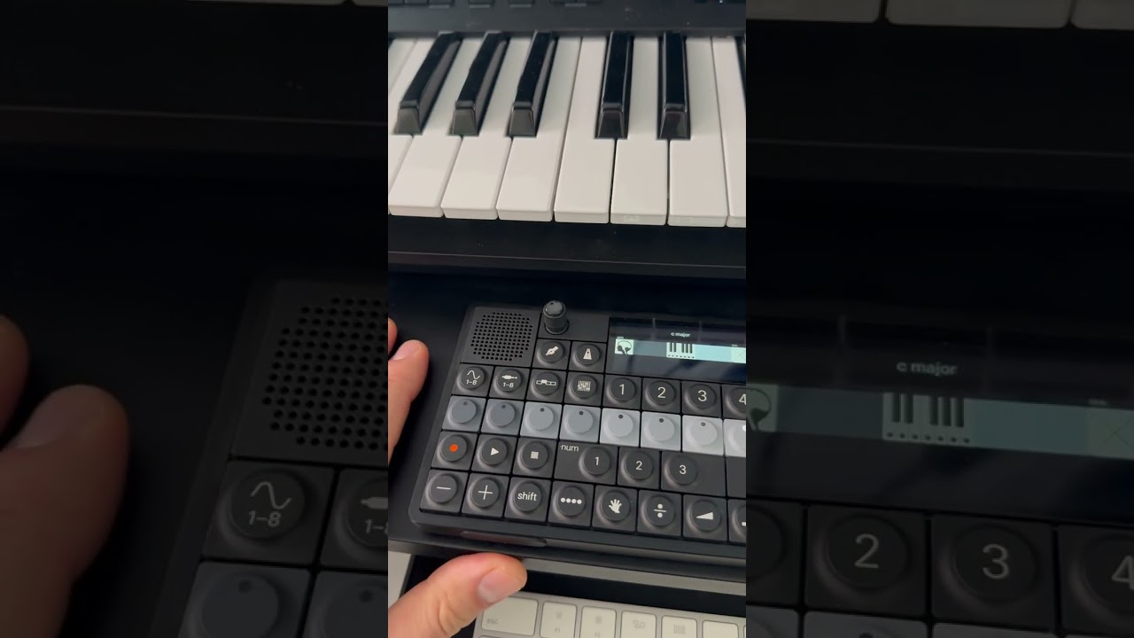

Has anyone experienced this strange bug? Almost any synth and sampler will play sharp. It goes in tune when switching to the aux instruments. I’m running latest 10.25 firmware, but the problem was in the previous firmware as well. Is anyone else able to replicate this? Wondering if it’s my unit or fundamental to the product.

Sounds like you have a unit with one of the wonky pitch bend buttons. Have you tried the PB calibration in the settings?
Wow, I think you’re right. I tried calibrate and it does not seem to succeed. I can press left and it prompts to release. Then it prompts to press left.
I press left and it prompts to release. I release but it never changes. Still says release. And the graphic is skewed to the right. Just a little sharp.
Thanks. I guess I need to submit a support request. Anyone know what they will do in response?
You’ll probably have to send it back for a replacement.
TE says to return it to retailer. Back to Perfect Circuit it goes. Sadness.
