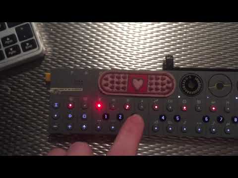

remove the cuts ( in your sample settings on op-z )
im talking about this method of reediting the sample cuts :
i have put your file into chord track (8)
track 6,7,8 are a bit different sampling method, no cuts, sounds totally different:
audio is direct from op-z usb-z
it has cracks. but with sounds there days you never know weather its a glitch or an artistic expression :joy: so you decide
