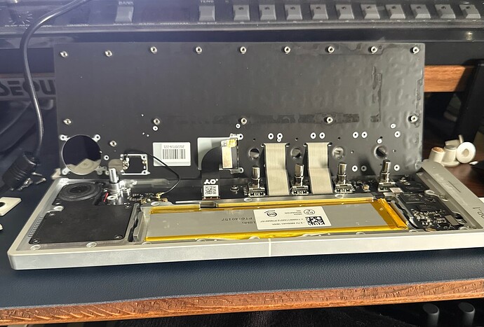

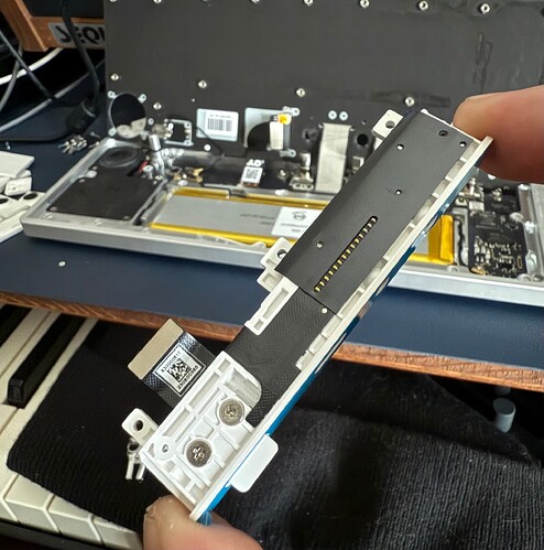

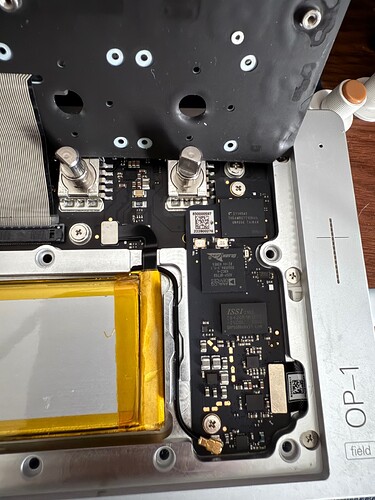

It’s not that hard to get to but no one sells the boards. I had a faulty one I’ve been sitting on that wouldn’t connect headphone/mic or usb. Today I decided
to just try to take it apart to see the inside and managed to get it to work over usb again which makes it usable considering it does audio over usb
Got it working fully again. After messing with the ribbon cable that connects the IO board to the unit.
