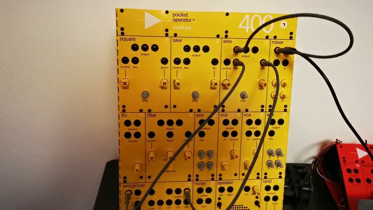

When I connect an external clock into the clock in of the sequencer, the BPM is picked up but it causes the sequencer to skip 2 steps…
so the sequencer plays the steps in the following order: 1,4,7,10,13,16,3,6,9,12,15,2,5,8,11,14

I have the OP-1 output setup to send clock (this can be accessed through the metronome button, with rotating the green knob to po clock and then pressing shift and rotating the green knob again to say “1/16 clock”) through the left output channel which I connect to the “cl in” of the modular.
The modular does pick up the rhythm, but the sequencer stops following the right order !
Let me know if this is clear, otherwise I can share a quick image.

Had some parts where it were constantly doing the same thing but then it just kind of out of tune and totally messed up. in the following video I moved every second knob on the sequencer and had the cabling like you said and it seemed to work? Like it played every second note, so I cant confirm your issue.

Teenage engineering confirmed that there was something wrong with my sequencer unit so they have replaced it. They were were helpful and they also explained other questions that I had!
