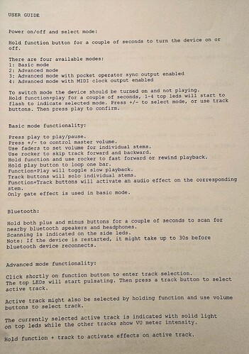

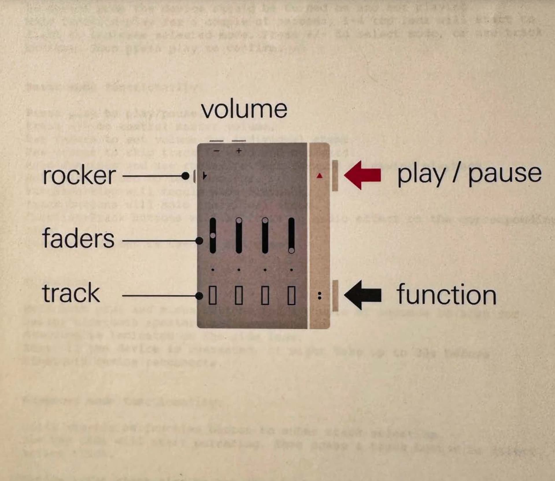

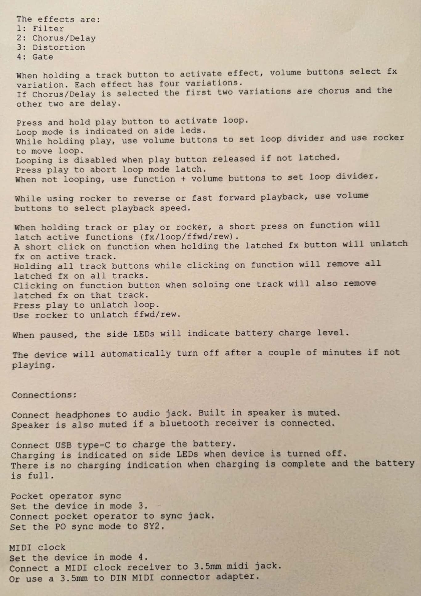

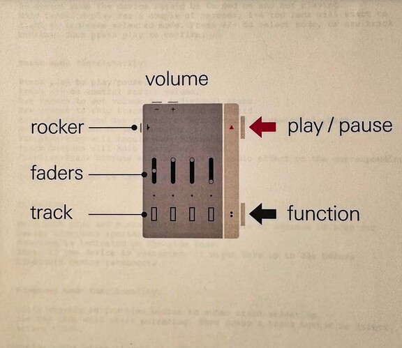

official TE paperwork :clipboard:

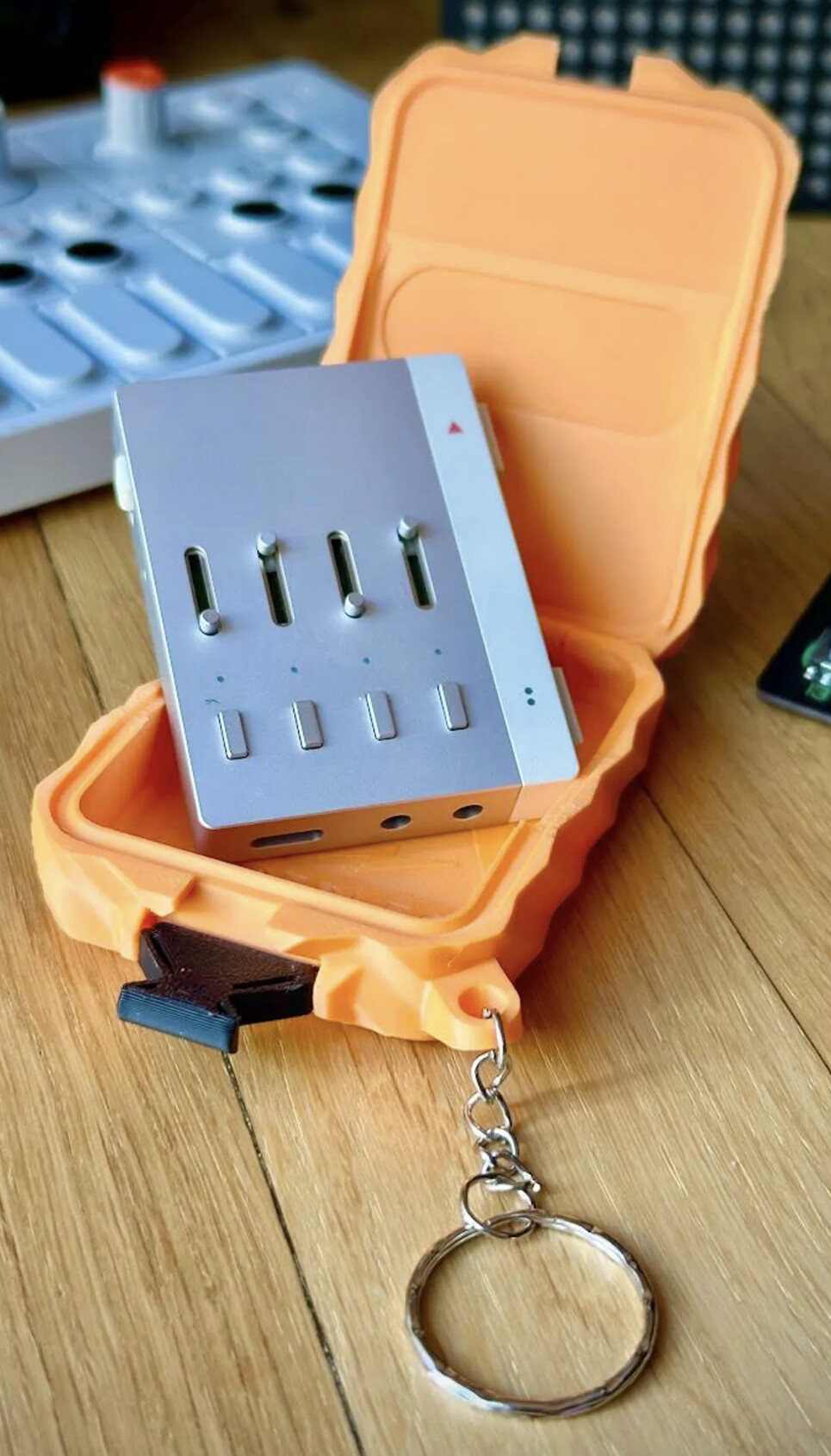

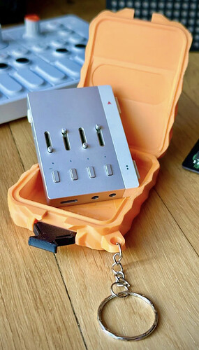

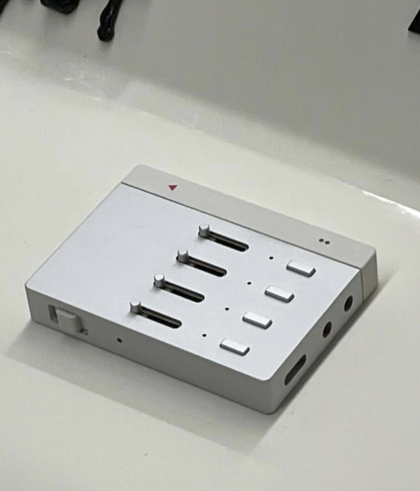

grab a case for it here :arrow_heading_down:https://www.etsy.com/listing/4521053156/te-sp-1-case
