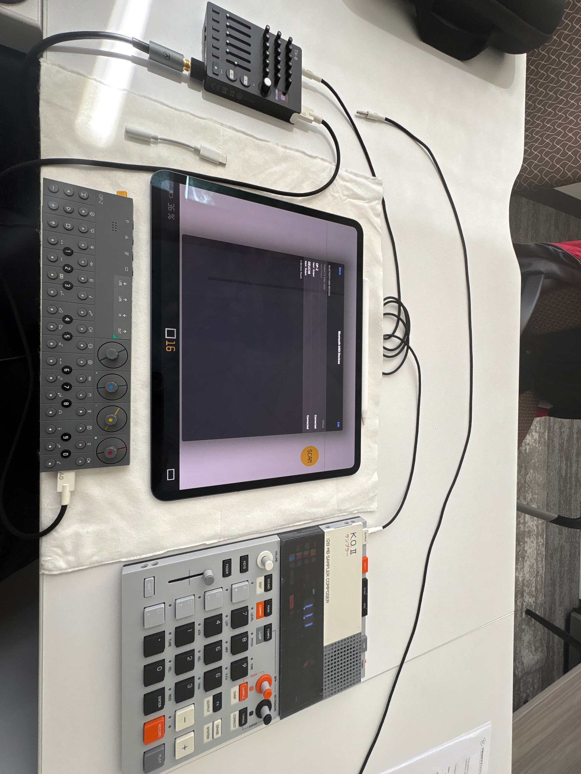

Just wondering if it’s possible to sync the two devices together so that I can essentially press play on the TX-6 and start the OP-Z’s sequencer?
I’ve successfully synced the OP-Z and my K.O.II over USB-C but no luck with the TX-6.

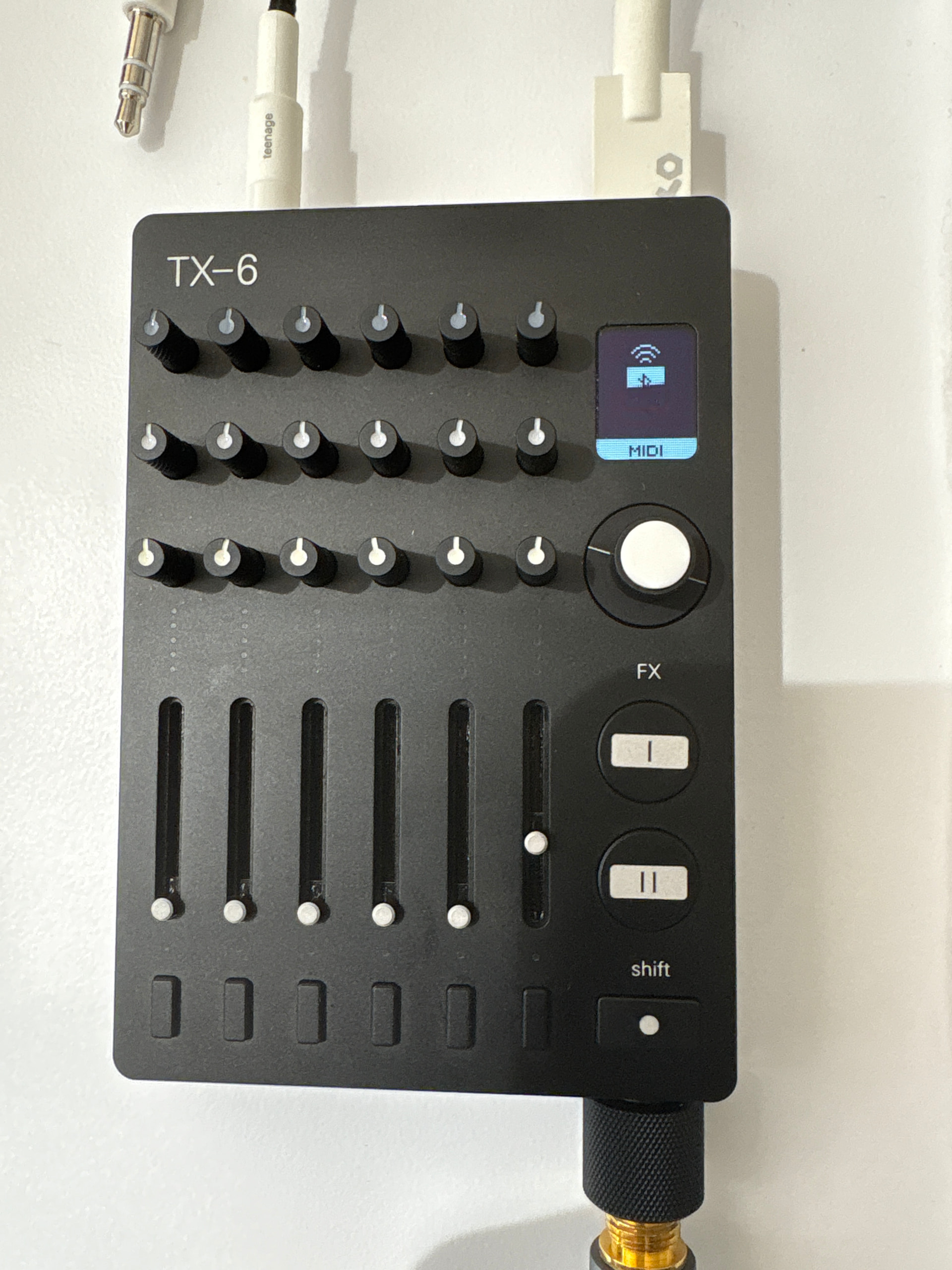

I can connect it to the OP-Z via USB-C and scan for the deceive on the TX-6 but it only showcases “midi” after connecting the two. Any thoughts?
should be possible. make sure tx6 is sending transport out using its internal clock in the midi and tempo settings
