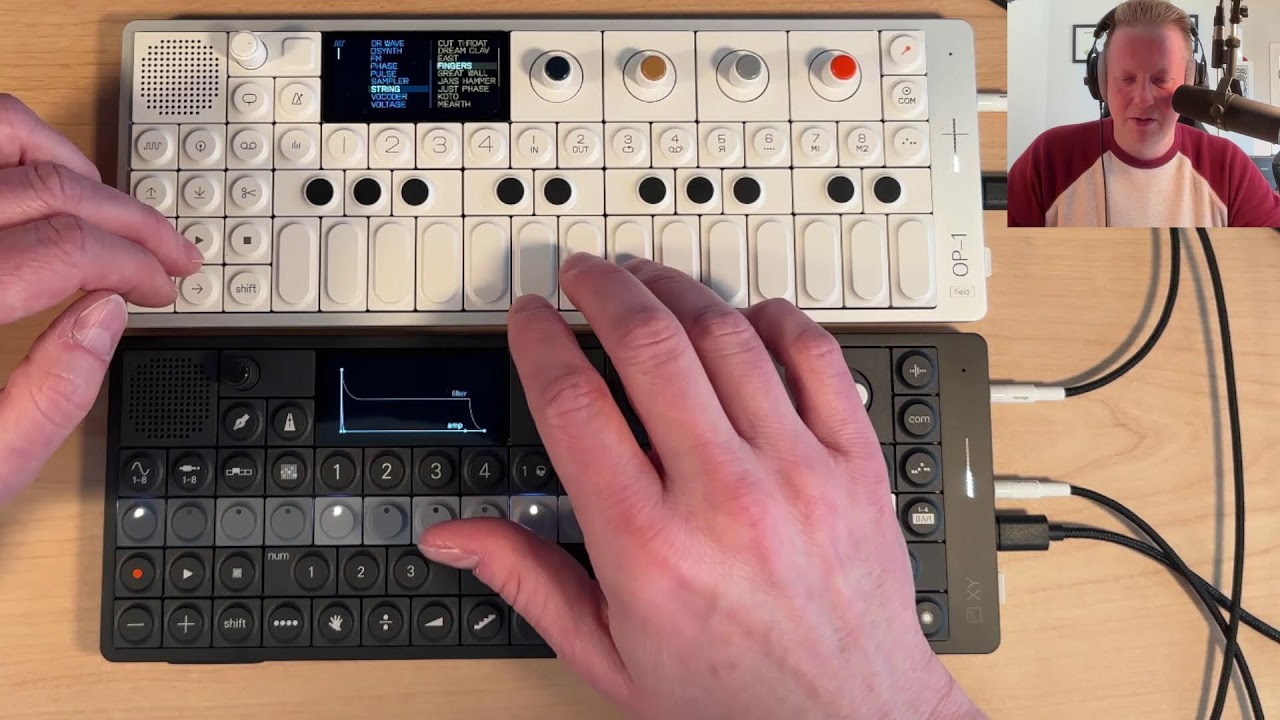

I did this a while ago… and I know the notes are a bit around the place… but this is what I’m assuming you want to do and I do explain different parts of the setup to get this to work…
