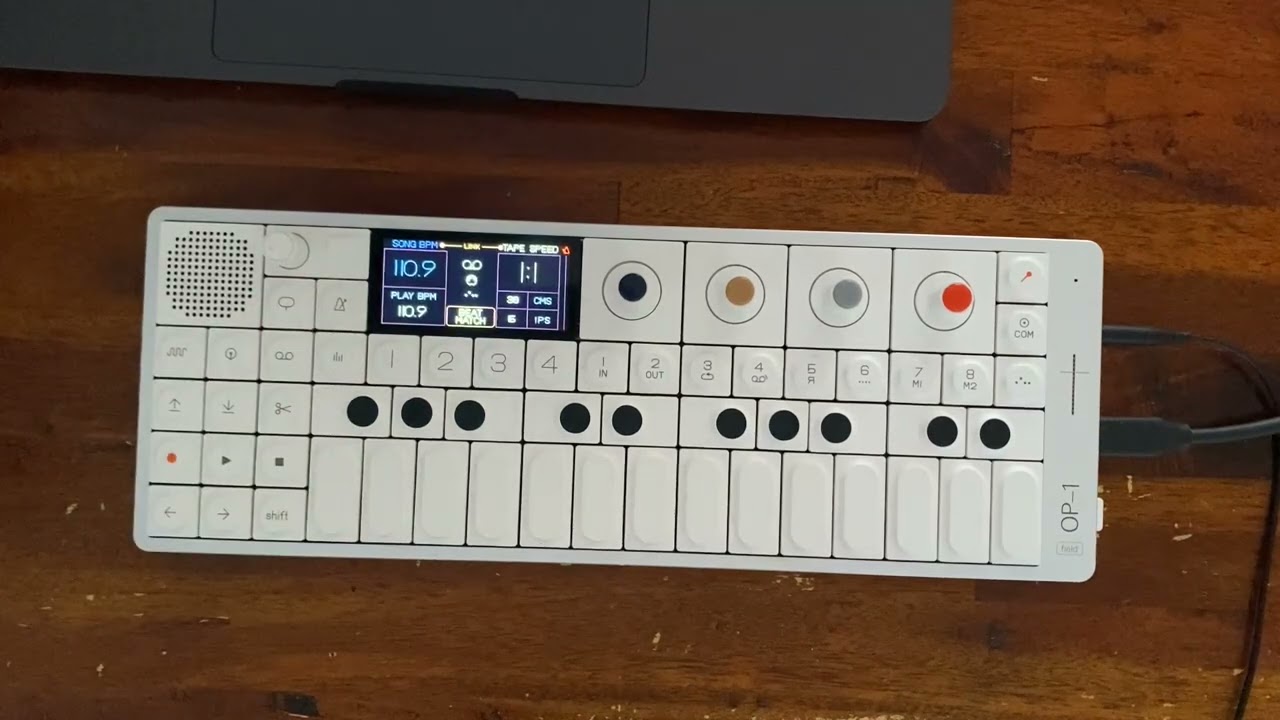

After posting some curious things in the OP-1 update thread, I found a somewhat more distressing bug. I hope anyone can assist me in replicating this on other devices.
I noticed most of my tapes were somewhat misaligned after the update. I almost always keep my BPM in whole numbers, but curiously now they’re all in decimals, slightly off from what they used to be. When setting the BPM back to an exact number, turning the device off, and then back on, again it’s 0.1 off. This results in the tape markers being misaligned, more so the further you get to the end of the tape.
Here’s a video of this happening. Excuse the harsh sound, it’s intentional but might not be to everyone’s preference.
What I did here:
  • First played the tape section exactly as recorded, using shift+3 to create loop points around the recording; no clicks whatsoever, perfect loop
  • Then played the tape again, but fixing the loop start and end on the tape markers, resulting in an audible click when looping around
  • Turned the device off and back on again. You can immediately notice the markers and tape being misaligned
  • Played the tape again from the loop points that were previously saved - same audible clicks
  • Fixing loop start and end on the markers so the misalignment is audible
So all my recordings now being misaligned is somewhat… discomforting.
