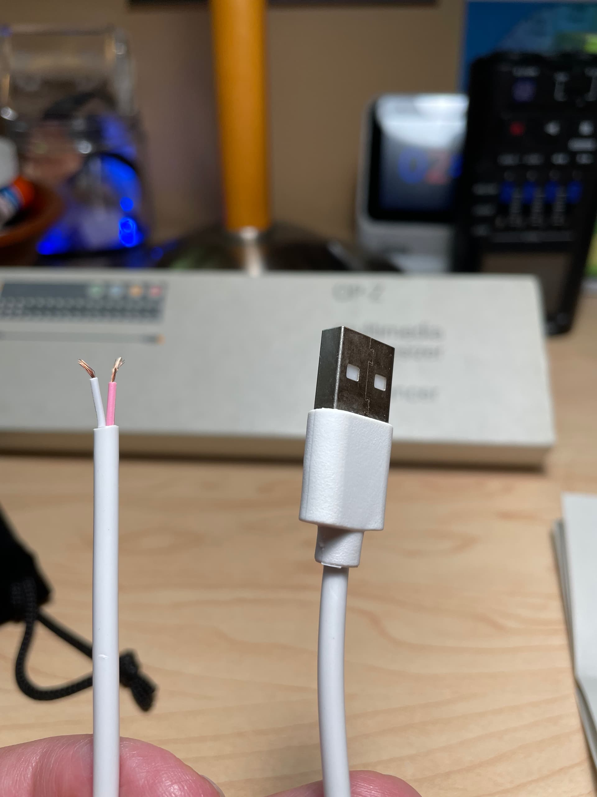

That dead battery you have might just need a kick start and it will commence to charge properly and return to active duty!
Take a 5 volt dc source, stripped usb charging cable in my case, and hold the lead to the +/-, observing proper polarity, for approx 15 seconds!
That’s it!
Place the battery back in the case and a charge indication should appear. Mine was fully recharged in 90 mins.
Hope this helps.
