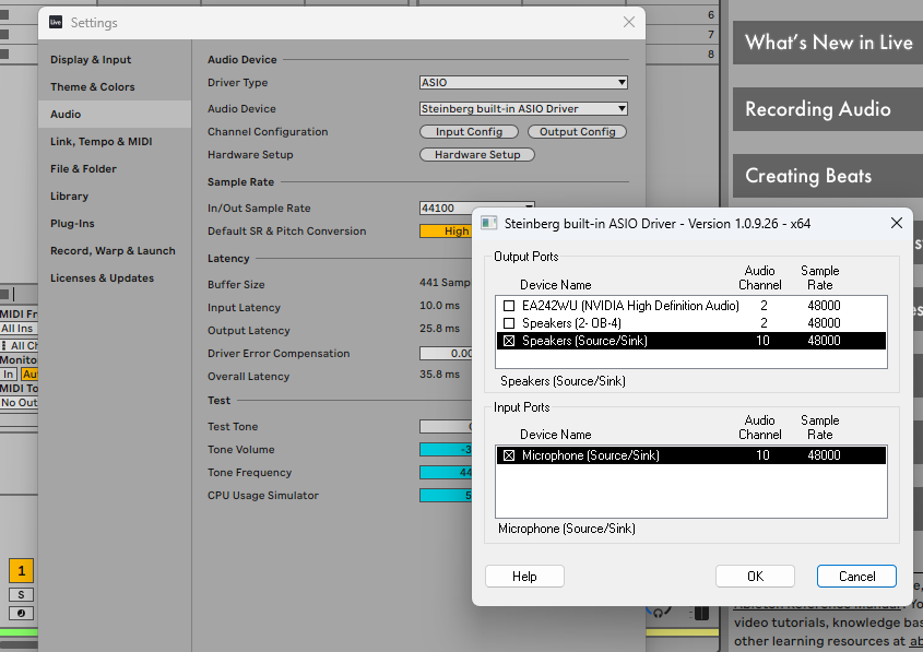

i don’t have a tx-6 but i have a torso s4.
the s4 has 10in/10out on macos over usb, but when connected to windows only has 2in/2out
i installed the steinberg built-in asio driver from here: https://helpcenter.steinberg.de/hc/en-us/articles/17863730844946-Steinberg-built-in-ASIO-Driver-information-download
and now the s4 shows up with 10/10 when using the above driver in ableton, etc. tested, working fine
just curious if anyone with a tx-6 has given the above driver a shot, or would be willing to try it and see if it works
i use both macos and windows, and having support for all channels on windows may be just the thing to convince me to pick up a tx-6
i recently got a tx-6 and can confirm that the above steinberg asio driver does NOT enable all 12 channels on windows. there was some discussion about beta testing a windows driver on the te discord, i replied a few weeks ago willing to beta test it but got no response, but perhaps they are working on something like that?

i haven’t used the tx-6 too much with windows, mostly been using it stand-alone, but maybe give that steinberg asio driver above a shot and see if it helps? i’ve used it a couple of times here/there with windows and it seems to be ok, but i think i did experience some glitchyness prior to using the steinberg asio driver. windows 11
