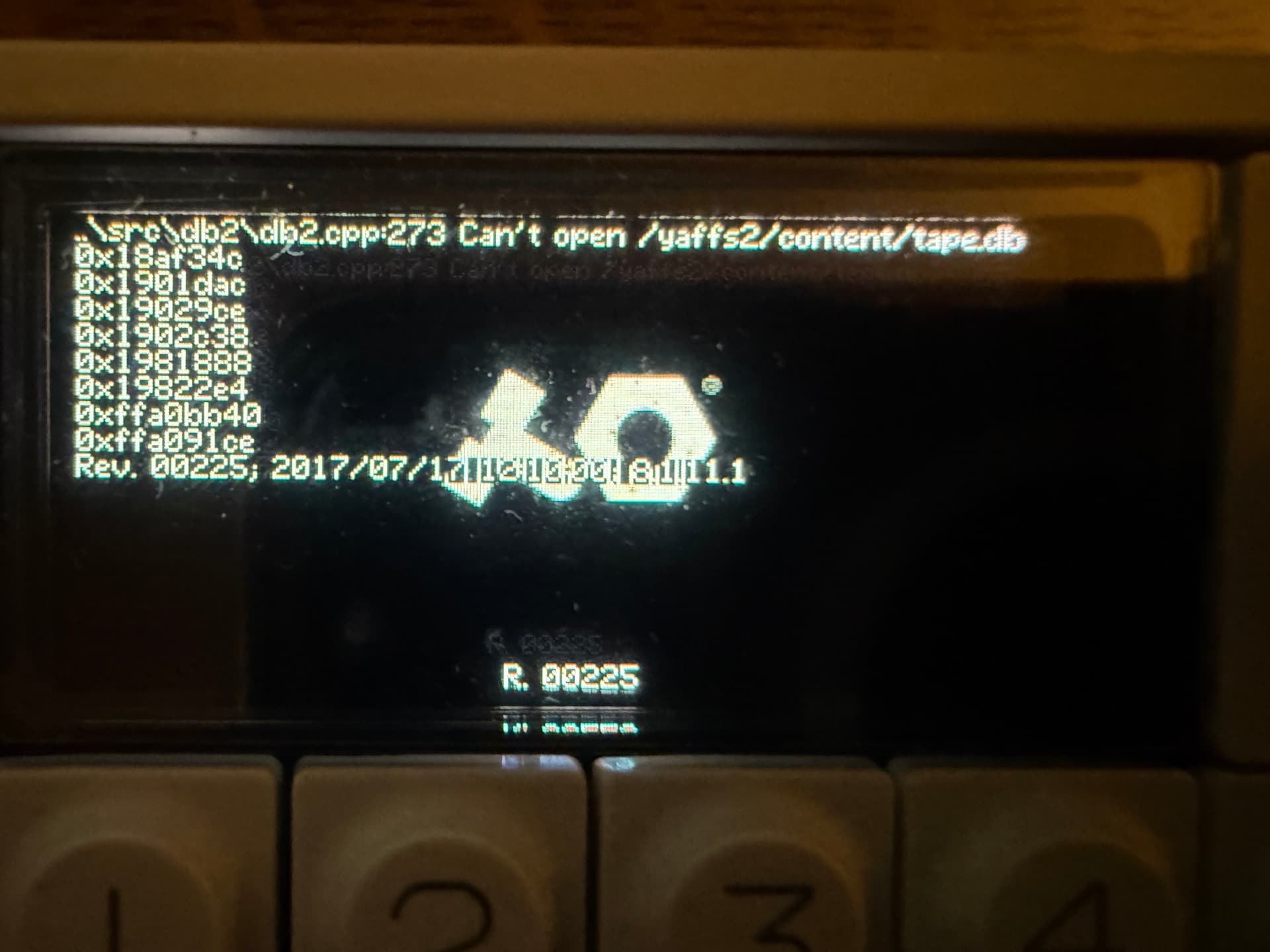

Is there a decent US repair shop for an OG OP-1 in 2025? I have an OP1 that is spitting out code upon startup. It’s had a new USB board, passes all tests, can get to TE. boot, but if you connect a USB cable to it I won’t connect to the computer (it will charge).

I can access TE boot, I can reset it it, I can format it up to a point… my problem gets to where it says “connect to computer”. I will connect the cable and it just does not register that a cable is connected. I’m unable to upload the firmware because it never sees that it’s connected.
I’ve tried multiple cables, including the original TE cable. And it’s a replacement connecter board.
