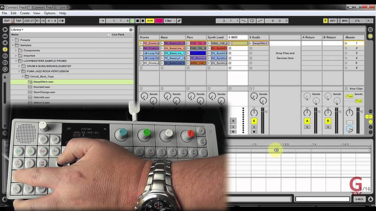

do you have any videos of how this works?
i can’t seem to find any
had no idea op1 could do anything beyond simple midi controls for a daw plugin
