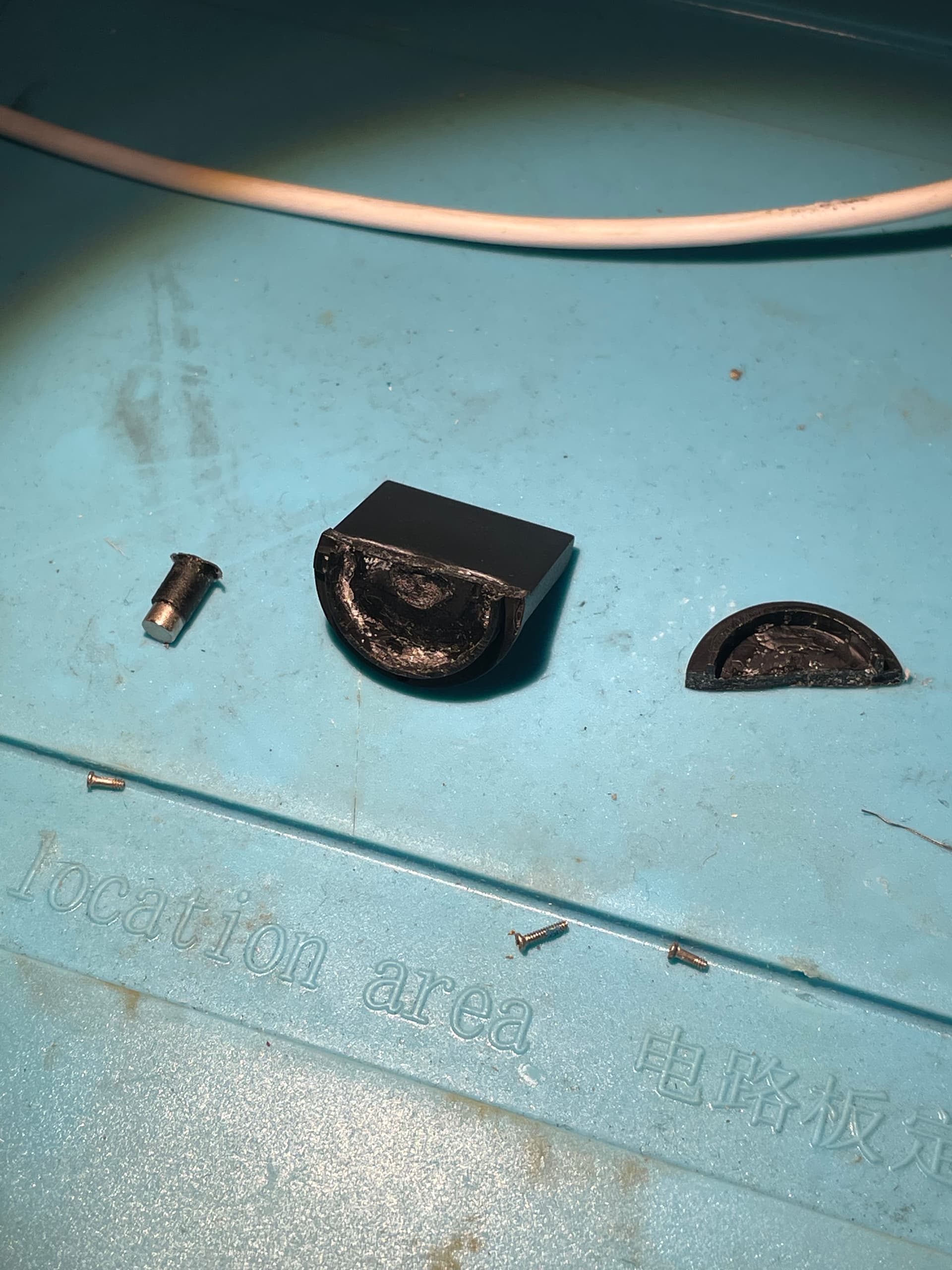

My cat had broken my volume knob by knocking my OB-4 off a shelf, and I had success glueing the knob back together and into the unit.
Well, it happened again, only this time I tipped it over myself by pulling a cable I did’t realize looped behind it, and caught it, but the knob popped off in my hand.
So this time I figured I’d share some pictures from the “process” of the “repair” lol
This ring is clocked to the center magnet piece, but a recalibration will take care of that.
After glueing the pieces together I applied a little glue to the ring and inserted the reassembled knob into the encoder motor.
Then I performed a calibration by holding both buttons through the loop screen until the recal prompt popped up and pressed and held play to complete the recalibration.
Fully functional again! I decided to stick with the superglue instead of trying an epoxy because at least I know if these 3 pieces come apart again I can fix it!

yay, was able to fix mine. Mine broke more cleanly, plastic intact, just snapped the encoder magnet off the post.
I had a fiddly time recalibrating; perhaps the bearing had a little more drag than nominal, or my magnet was a hair misaligned.
Helping it by very lightly applying force with my finger while it was traveling to the limits let me get it at least able to power off. Then I had to futz with it more (incl just jogging it back and forth by hand a bunch, maybe loosening it up a bit) before it did a full calibration movement between min and max positions.
But I think we’re good now :crossed_fingers:
