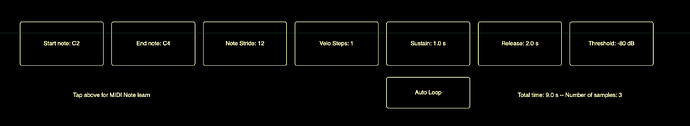

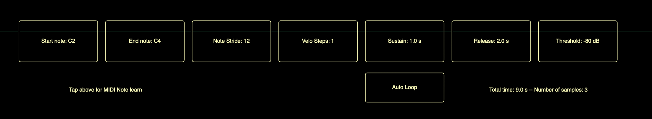

AudioLayer does have ‘note stride’ which is the interval gap between recorded notes. It also can do multi-velocity sampling (up to 32 velocity layers!)
Here’s the auto-sampling options it has. It’s quite nice.

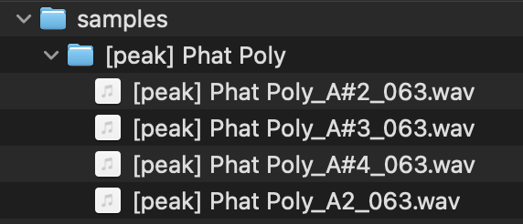

It auto names the samples nicely as well:
