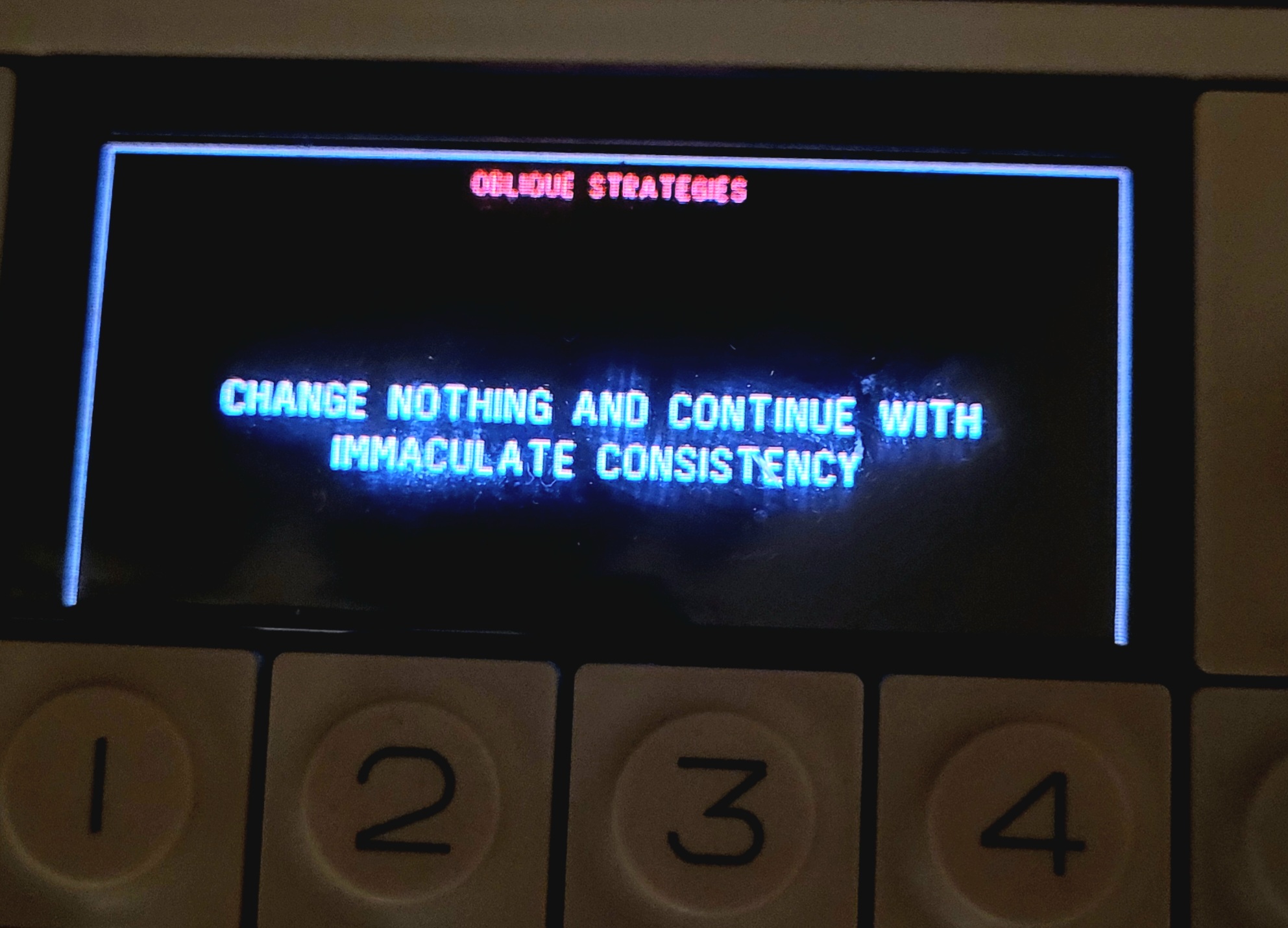

Opus 5.5 medium, no blocks so far. Just included a small feature to display a random Oblique Strategies card when pressing shift + orange encoder press:
@popcorp - you mentioned you may accept contributions to include, would that be possible? Repo is here: GitHub - ultralazr/op1-oblique-strategies: Oblique Strategies cards on the original OP-1 (firmware R246): Shift + orange encoder press · GitHub – it also includes a MODDING.md guide written for agents. Amazing times.

thank you so much for putting that into the OP1 just for it to be there and if you really get stuck and don’t know why this will help escape that circle simply by disrupting it so elegantly that the moment you think that’s a bit cringy, the card already did its magic :sunny:
exactly how it works, check the update (shift+bubble) :wink:

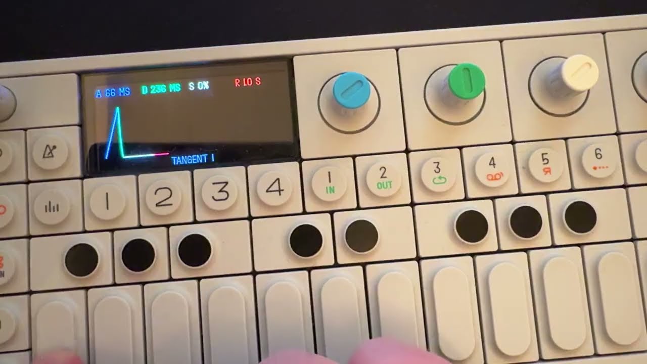

Who would have thought the OG OP-1 would get individual ADSR envelopes per sample before Field and OP-XY :eyes:

Just a note on governance, I think a canonical registry is critical to avoid chaos down the road. GitHub - LizardMan245/op1-mod-registry: Which names and numbers each mod for the original OP-1 (firmware 246) adds, so mods and their sounds don't clash. · GitHub looks like a good approach right now. Just mentioning this since I registered Oblique Strategies there with Shift + Orange encoder press, but it got merged with Shift + Help Bubble by @popcorp - Either way is fine with me, but centrally registering this would avoid clashes down the road… or maybe we need a configurator app on top that highlights any clashes before repacking and the user can choose how to resolve them.
