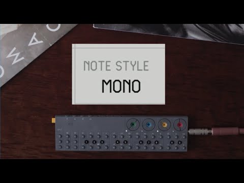

I donāt think the chokes work in āgroupsā but rather if you set it to mono, all the samples on the track become one choke group. I made a quick tutorial video on the update and using mono sample in case it helps - feels more like an MPC vibe ![]()
@ryandiefenbach got it right. The whole track becomes a choke group.
