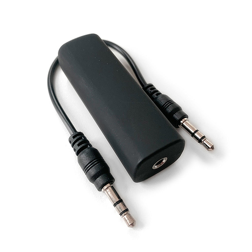

Yes, constructive cynical criticism (BTW, AKA as CCC 2 u n me) is fine, but, please, is there any way of charging while playing without being drowned out with that horrible noise? I even tried setting up a few meters away from the monitors I had on nearby, and it wasn’t the monitors… Tried various different chargers, USB and the one powering my Organelle, and it wasn’t the chargers. Is it just a ground loop??? I honestly didn’t find the USB noise on the update to be worse, but it certainly didn’t get any better. Anybody try a simple in-line stereo ground loop filter on the audio out? I’d try soldering one up, but I’m afraid of burning my house down… :man_shrugging:

ground loop isolator will most likely cure that noise
Yes, I have one of these and it fixes everything.
Cheap fix. I didn’t buy the retrokits one. I got one off Amazon that looks exactly the same.
Only thing I haven’t tried is an Apple brand adapter. Interesting. Those noise isolated devices can be ok but with my experience theY clip super easy and distort. I’ve dealt with it sometime now but for some reason it seems a little louder than normal. Nothing crazy but caught my attention.
i haven’t noticed any clipping on mine
but if u don’t like the audio ones
try a usb ground loop isolator.
results are the same but you’re not putting anything in the audio path
