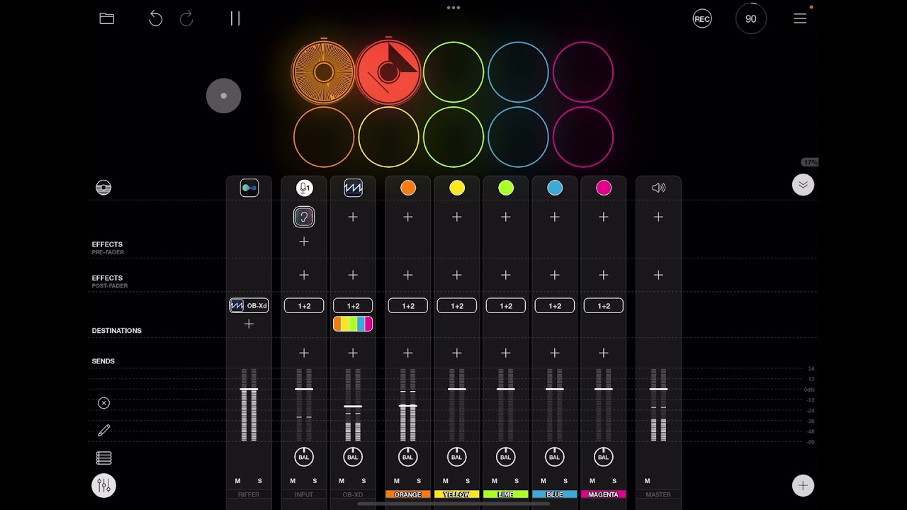

Connected OP1F w/ iPad with usb C (TE cable).
(Firmware: 1.4.2)
Then I got the app Loopy Pro to record the audio from the OP1 tape audio into Loopy Pro. :ballot_box_with_check:
Also I was able to start the OP1F tape in sync w/ the Loopy Pro app: so tap play on Loopy Pro sent midi to OP1F to trigger tape start. :ballot_box_with_check:
I thought this was helpful:
Didn’t try to send audio from the iPad yet.
