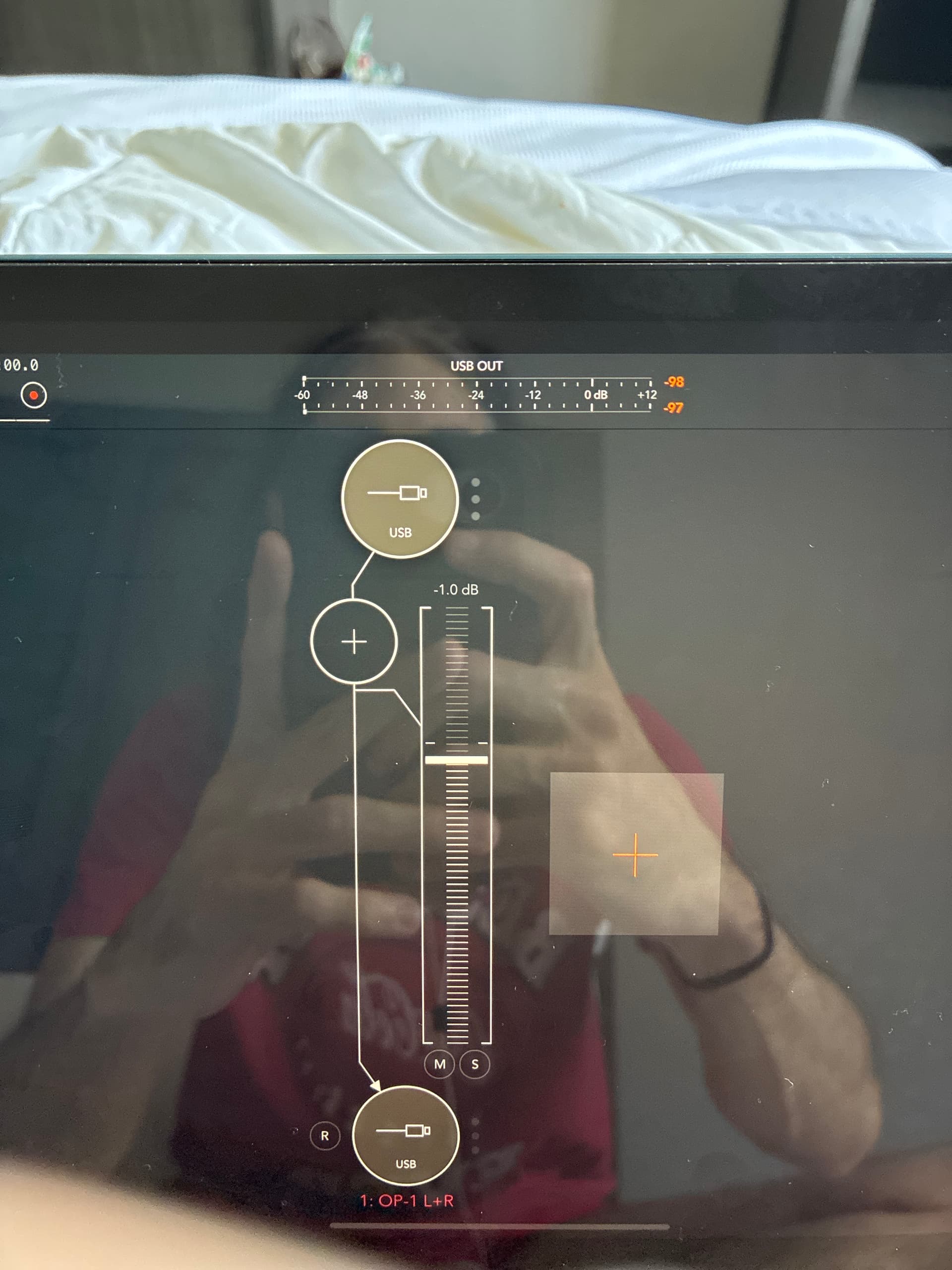

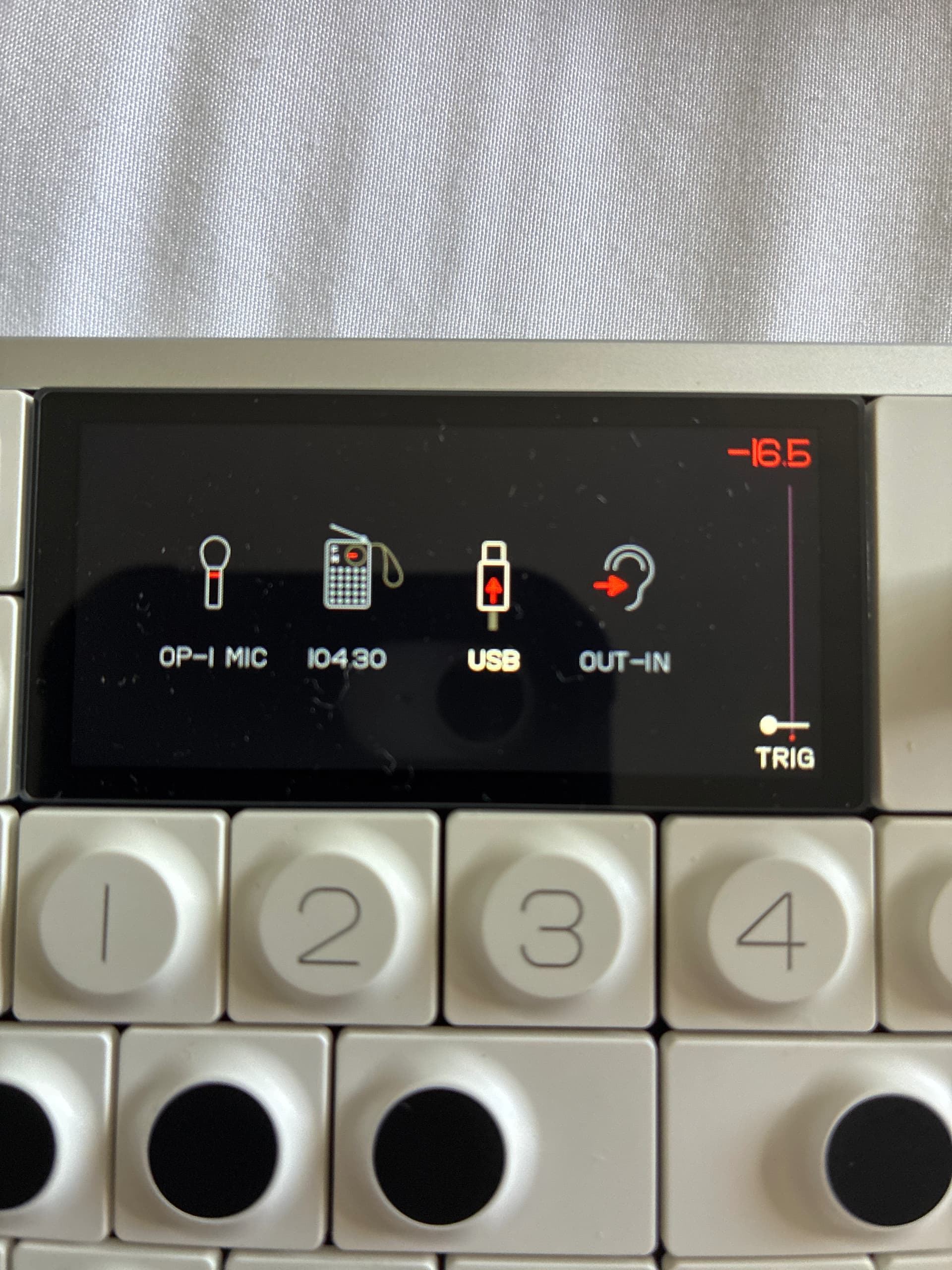

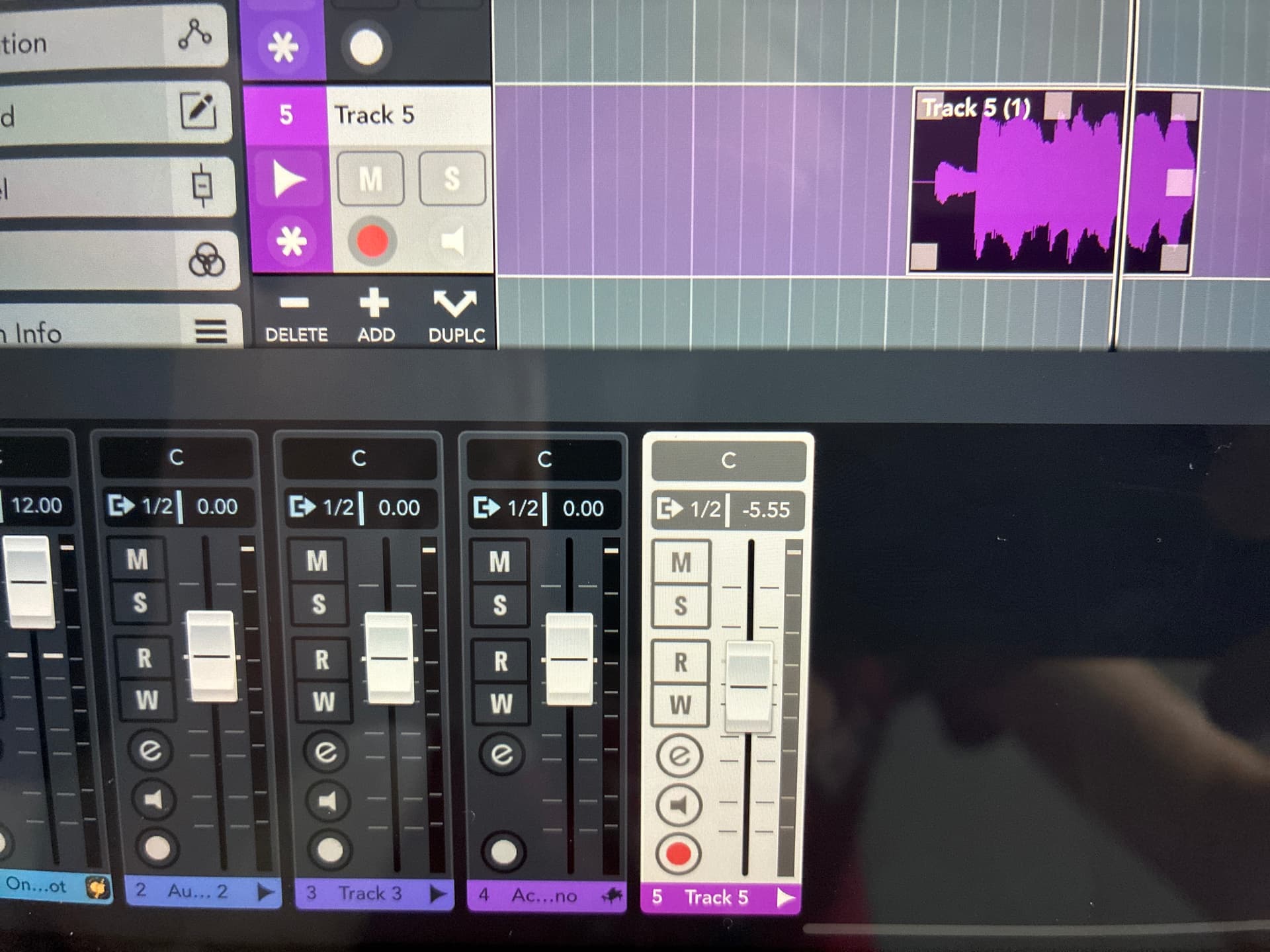

Hey ok so for AUM I set the usb C input volume to -16.5dB to avoid that feedback loop
In Cubasis I just disabled monitoring
The headphone button above the record arm button on mixer or the headphone monitor button under the silent button on track 5 is what I’m showing ^^
Let me know if that helps but it definitely works for me. I wish we didn’t have to worry about feedback loops but it’s hard considering how compact the device is so hope this work

Man thanks so much for your kindness and attention to detail to post this. These are all of the things that I have tried and they just don’t work for me.
I also do a lot of film scoring and need my OP1f to be a decent monitor device. The feedback is just “always there “. It’s too much of a risk and it causes too much noise even at low volumes.
Let me also add that even if you record at low enough volumes to not feedback, you still can’t use the click in Curbase because it will get folded back into the recording as well.
That I’ll have to look into because that hasn’t happens to me . It comes out rather clear actually…maybe do a screen recording to post and so I can try to replicate it
