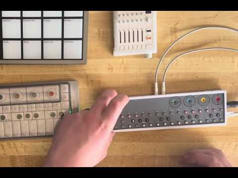

I’m not sure if everyone knows this, but if you want to move recorded notes from one track to another on the OP-Z, you can do it using the line module. Simply connect a 3.5mm cable from your MIDI in to MIDI out, then access your MIDI settings by holding down Metronome and the screen button simultaneously. Turn on MIDI out and MIDI in, by pressing the numbers 2, 3 and 10.
While still holding Metronome and the screen button, press and hold the track you want to receive MIDI on, then turn the green dial to select the desired MIDI channel. Release the track once you’ve selected the channel. Next, while still holding Metronome and Shift, press and hold the track from which you want MIDI sent, and again use the green dial to select the same MIDI channel you chose for receiving.
Now you can release the Metronome and screen button, navigate to the receiving track, and hit record. If needed, I’ve also created a short video demonstrating these steps.
damn that is insane i had no idea. how did you figure this out?
When I noticed the MIDI echo feature for MIDI Thru, I realized that you could probably use MIDI in and out simultaneously, so I started experimenting with it.
that’s the exact behavior I discovered like 6 years ago when I set up my raspberry pi image to control everything with usb midi….this way I created a midi loopback which had the ability to record from one to the other track :see_no_evil::sunflower:
