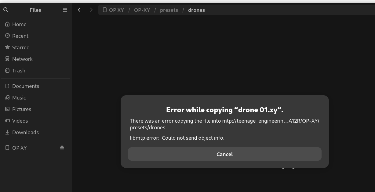

I just tried to copy Colors’s drone presets from a Linux (Fedora 41) machine, and while browsing the connected OP-XY as MTP device works just fine I’m getting libmtp error: Could not send object info when I try to actually copy the *.xy files into a dedicated (successfully created) folder below presets. Naming looks fine, files are around 7kb..

Here is a screenshot - it pops up in the moment I try to paste a file:
But I really doubt it’s related to your content in any way but rather a protocol error or the wrong cable. I guess Linux and MTP are just not the best friends :slight_smile:

Hey John, was my fault, see updated OP, thanks for your instant feedback, though!
