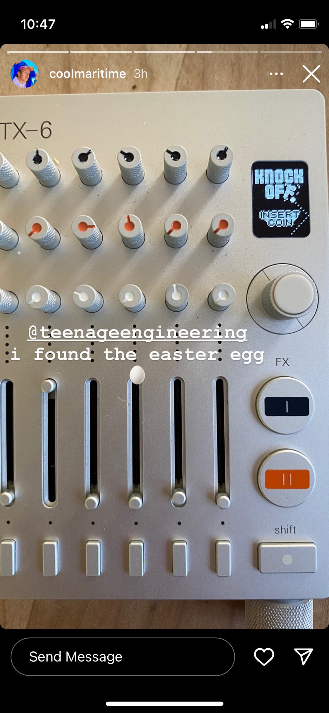

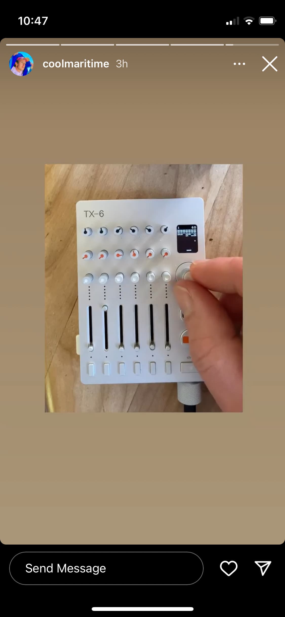

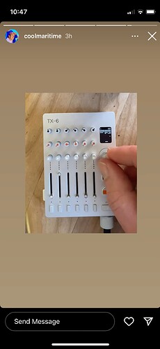

Over on Insta, Cool Maritime for the win!!!
How do we enable that
It’s a secret!
it’s a button combo, but so far no one has spilled the beans. i don’t think anyone has even said how many buttons are in the combo. i tried for a while last night, but with so many buttons and an unknown number of them involved… i didn’t find it.
So nobody over here is talking yet? :shushing_face:
I’m talking but don’t know the combo :sob:
I signed up here after lurking for some time.
I have a TX-6 and hunted around everywhere for details of how to get to the easter egg. But I worked out the buttons needed within 30 seconds of trying combos.
The game is nice, but using the sounds or mixing it up some more and keeping a high score leaderboard would be even better!
hearing this makes me really nervous- i’ve been trying for the button combo ever since i received my unit weeks ago, right when it first was released. i went as far as to make a matrix on paper of every possible button combination… so either the combo is based upon the order in which things are pressed (i didn’t systematically search that yet), or its based on being in a certain menu when buttons are pressed… or then my unit is broken which is what i’m most afraid of!!!
wouldn’t this list be in the thousands? Anyway, is it a button combination pressed before powering the unit or after?
nah, its not in the thousands, pretty easy and fast to systematically work through them, and also i was guessing that the combo has to be physically accessible. some of the button combos can be pressed, but they are really really difficult to do with 2 hands just due to the size of the buttons and their location.
i was also going through the more obvious button combos while turning on the unit but didn’t find anything that way either.
I’m not bound by any secrecy, but it seems the right thing to not reveal it directly.
I’m running 1.0.8, which is what the unit came with. The button combo seems to work at any point - it’s a three button combo, but you have to hold the, down for 5 seconds.
