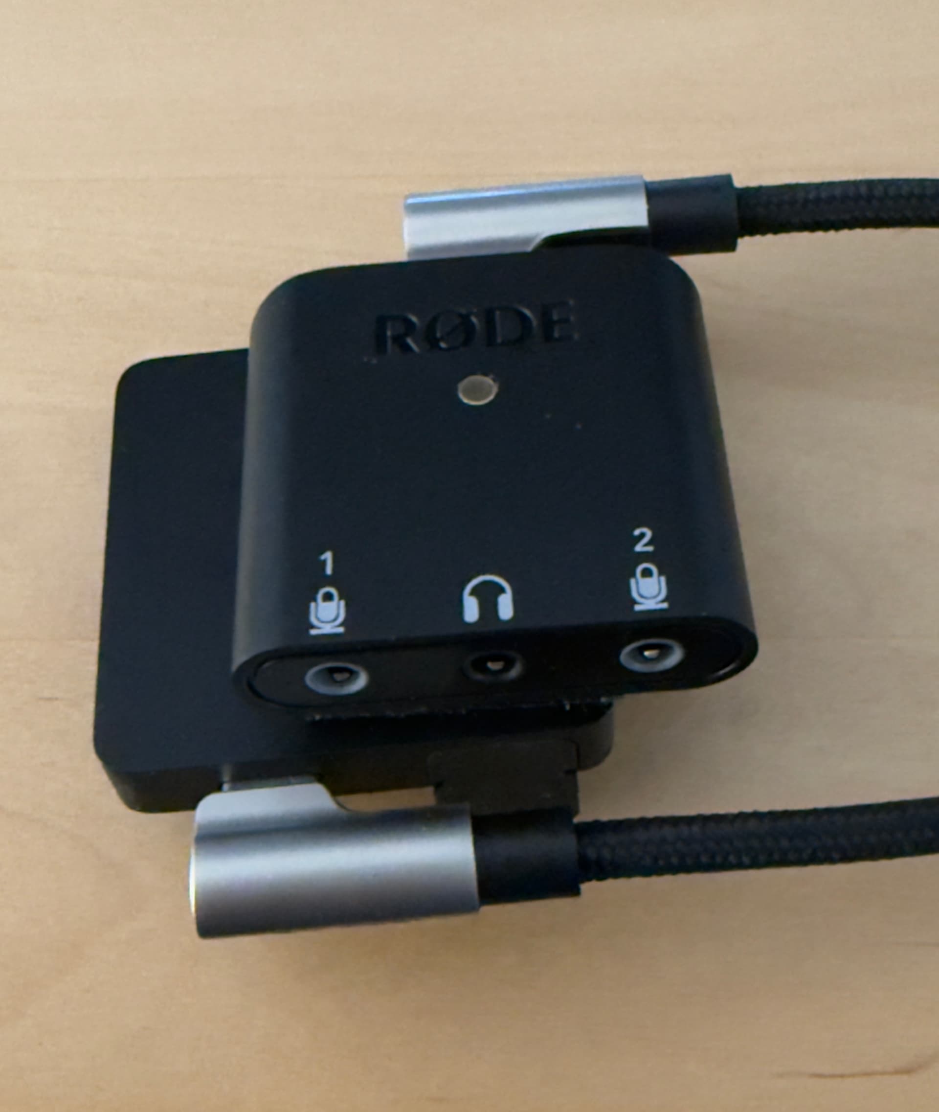

The only solution I have found for a stereo recording free of pops and clicks from TX6, direct on an iPhone is the RØDE AI-Micro. You can set input 1 to be stereo from the app.
