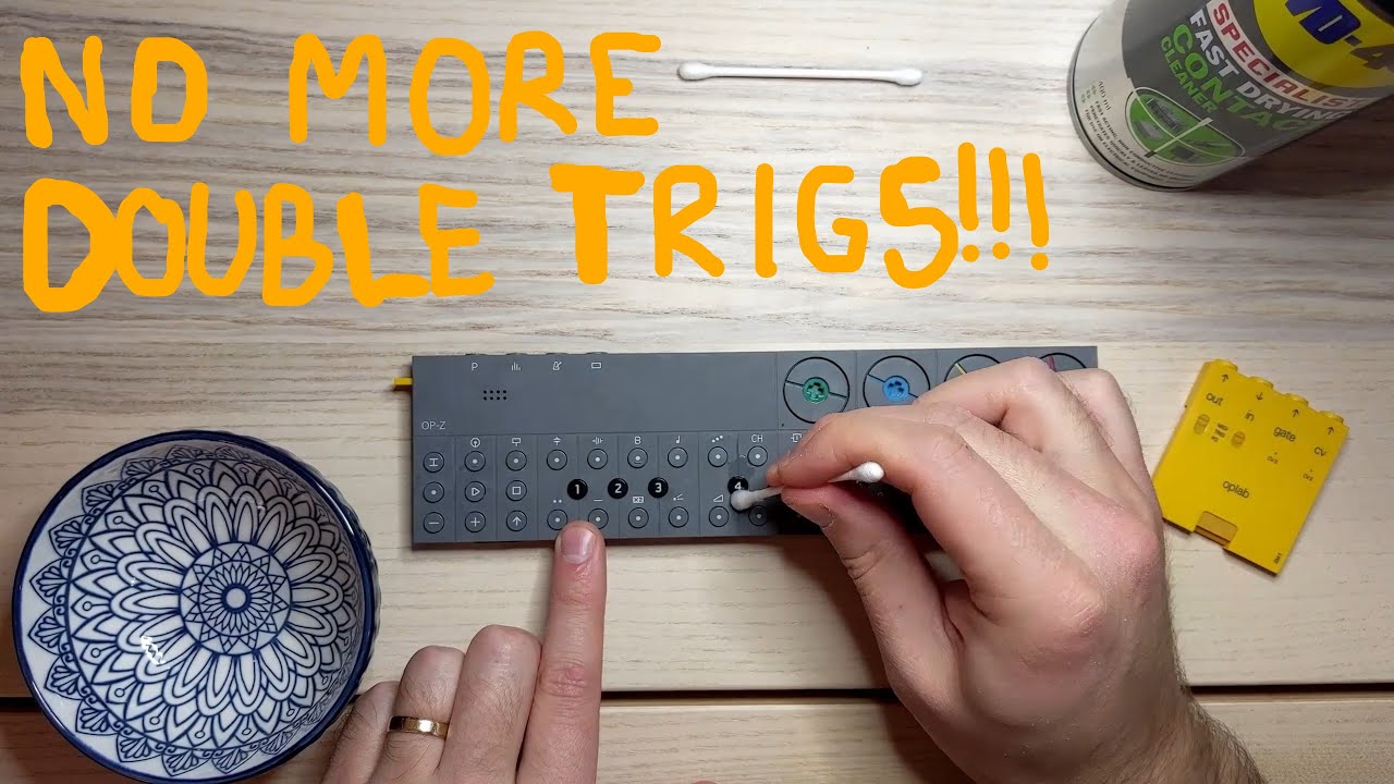

My OP-Z has been unusable recently due to double/multiple trigs, so I decided to try to fix the problem using contact cleaner, following advice from this Reddit thread. It works really well, I’m so pleased! I recorded the whole process outlining the problem and the solution as well as a quick modification to make the unit more stable. Hopefully it’s useful for someone facing similar issues!

FYI: I tried using the WD-40 “Specialist Contact Cleaner” I used about the same amount shown in the posted video. It seemed to work on a few buttons that had very bad double trigs. But it made several buttons stop working completely, unless you press down very hard the button will not trigger. I looked at the reddit post and found a link to the elektronauts. See below. In the elektron post it expressly says not to use WD-40 or other contact cleaners. “Only use deoxit D5” I have not used deoxit but from all of the material I have read, it seems like the way to go. regardless I hope my OP-Z eventually will start working after some time passes. BTW it has been 3 weeks with no improvment.
I’m sorry to hear that, it worked perfectly for mine, and a few people have contacted me that have used the same contact cleaner (WD-40 specialist fast drying contact cleaner) and it worked fine for them too. I imagine that the Elektronauts post is specifically meaning regular WD-40, the lubricating oil/water displacer, definitely don’t use that, as they specifically mentioned ones that are greasy. In the original Reddit post, the OP said:
The bad news? I used too much D5 and completely jammed a number of keys for almost 5 days.
I imagine it’s the same problem here, it could be that it just worked its way in quickly. Hopefully it dries out and releases the keys soon.
I agree… It seems like a lot of people have been successful with this method. I am hoping it will eventually it will start working again. Thank you for the input!
Worked perfectly for my OP-Z that had a couple of double-triggering keys that were bothering me. Put a couple of drops on those keys (easy with the needle applicator), pressed them 20/30 times, let the OP-Z rest a couple of hours, and it’s good as new.
