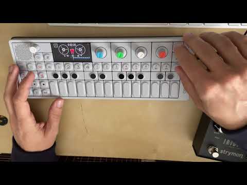

Hey guys, i made a video on this issue and will share it with TE as well as with my dealer.
That’s actually much worse than mine. Not that mine is acceptable at all. Hopefully your video will spur TE to action :slight_smile:
