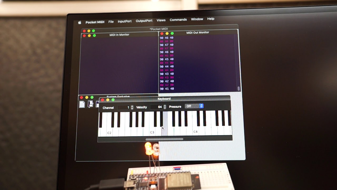

i dont have code for MiDi wired to ESP32. in my demonstration i wire LEDs directly to the MiDi jack and it blinks when ever there is a midi signal. (set only track 1 and 2 to output MiDi).
you can try it your self, take a midi jack and press LED to tip and mid.
where are examples of code online, how to add wired midi to ESP32, but than still, you have to code all the functions. I never took that direction🤷♂️
so for wired connection i recommend my CVmultipleXed code.

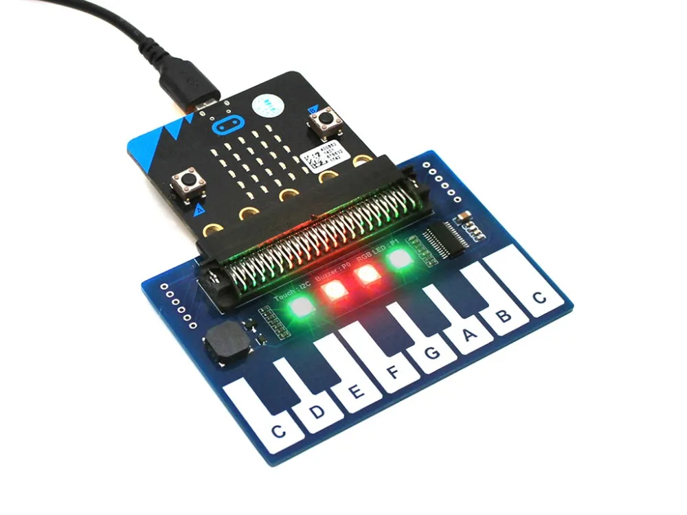

i think you might me on to something with micro bit !
unlike arduino IDE and ESP32, its easy to code, and it has already necessary MiDi frame work built into its SDK. i encourage you to try it out with MiDi. share your results, im very interested !

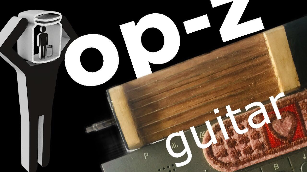

mechanical LFO motion vibrato
i dont have technical drawings for this project.
ice cream sticks are great for consistent size parts.
im sure this mechanism can be improved and can be executed in many ways.
