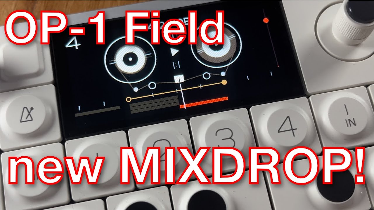

I posted a video earlier showing the Terminal FX (and modulating it with an LFO) but here is my one on Mixdown. This is going to be super handy for me since I previously had to jump through a bunch of hoops to do tracks 1+2+3 into Track 4, to make room for more. Although this will do 123&4 into a single track, which is even better. Previously that had to be done via the LP/Record master recorder.
